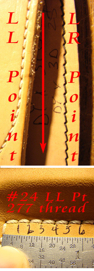

Moderator Art Posted December 28, 2015 Moderator Report Posted December 28, 2015 7x3 are for sewing canvas tents. I like Schmetz and Grös-Beckert. I like the D or Diamond point or the TRI, and sometimes the LR. The Japanese needles (Organ) are bendy as far as I am concerned, but I have yet to try the Ti coated ones I have friends that use Organ needles exclusively and love them. I use whatever I have (poly or nylon) in the color and size I want. I run Barbour's linen in my Campbell. Unless made of unobtanium, the price differences are not a factor for me. Art Quote For heaven's sakes pilgrim, make yourself a strop!

Members l2bravo Posted December 28, 2015 Author Members Report Posted December 28, 2015 Tinker, that is interesting. Mine are labeled Organ, and I bought a couple of extra packages as well. Art, what/when do you use the different points? What do you get in the final product, that is different when you do? Where do you get them at? Thanks guys! I am having a great time learning this all, and just want to learn more. Josh Quote
Moderator Art Posted December 28, 2015 Moderator Report Posted December 28, 2015 The D (Diamond) and TRI points tend to give a straight stitch line. The LR stitches have a little "cant" to resemble hand stitching. Art Quote For heaven's sakes pilgrim, make yourself a strop!
