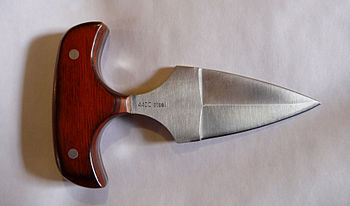

Members MorningStarL Posted January 7, 2016 Members Report Posted January 7, 2016 I'm not having good luck using the search engine, and I'm sure the answer I want is in the Forum somewhere. I make mostly knife sheaths, and I like a sewn on belt loop. Keeps metal away from the blade. The knifemaker just sold something to a guy who has a disability that prevents him wearing a belt. He's asked for a sheath with a metal clip. Since I don't like them, I've never done one. Is the answer to line the sheath? Which would mean two thinner layers of leather? And is there a way to attach them firmly to the sheath? The ones we have here look like the slide through a slot. What I'm thinking of is to cut two pieces of thinner leather than I'd usually use for a sheath,one for the lining; put the clip through the outside layer only; then contact cement both pieces together and go on stitching up the sides. The knife is a punch dagger, which will need a strap and Sam Brown stud (I don't like them either -- metal inside the sheath where it touches the knife blade). So I'd put that through the outer leather and secure it too, before lining. If I'm messing up here, I'd like to know. I've seen someone with a belt clip that isn't metal and seems to be attached to the sheah with a non-metal rivet. I've asked him about what he's using, but I bet you guys are faster. Thanks in advance, and happy New Year! Quote
Members kiwican Posted January 7, 2016 Members Report Posted January 7, 2016 Thats good question. I have made handcuff pouches in exactly the same manner as you describe and have had no negative feed back from the people that use them. I'm not a fan of clips either. Also, sorry to be a downer but the knife known as the "punch knife or push knife" where the blade extends between the fingers and and the handle is sort of a T bar design or configuration is actually illegal in Canada, Sooo be careful! Quote
