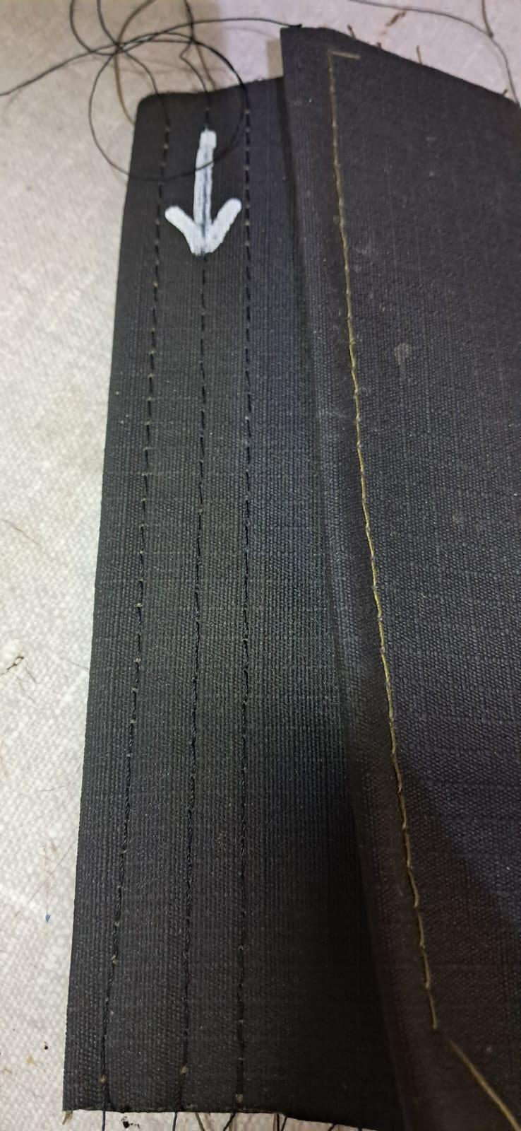

In your other above photo what is the material, looks coated, inquiring mind wants to know.

Lol.good luck with the young one...the material is called cordura 500g/cm we use it here to make schoolbags..very durable and weatherproof the 300g/cm is just to thin then a schoolbag only last 6 months..keen to see your note's

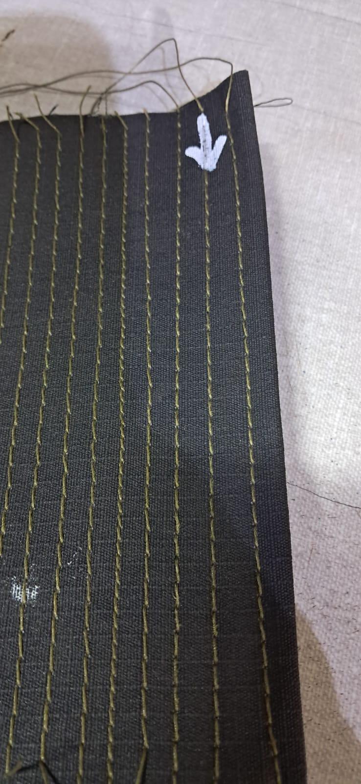

Some setting  on my timing is not correct , I struggle a bit finding what might be wrong when turning the wheel by hand I got about 3 stitches  then it is slicing/separating the thread when the hook passes the scarf of the needle, watching it from the bottom during the upward motion the thread is creating  a little  loop on the bottom of the material where the hook catches it again when turning past it thus creating tremendous strain and breaks the thread,
As the needle bar does not have marks on it I have set it up as described in the manual, with the needle to hook timing,  Might it be the tension mechanism that does not take up the slack of the thread, ,,,Oh well it's patience that keeps playing a big roll here to get what the problem might  be
