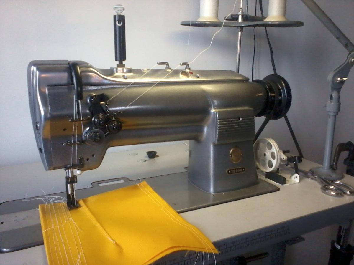

Members brmax Posted March 7, 2016 Members Report Posted March 7, 2016 Sounds like your on a roll, my 212 is not a walking foot machine but its ability makes it a pretty smooth machine. Went through machine when starting and now its a top dog again. Floyd Quote
Members maleman Posted March 7, 2016 Author Members Report Posted March 7, 2016 Now that is nice Floyd. When you say "went through it" what exactly do you mean. Any new parts like bearing, wicks, if it has them etc.....and at what cost and where did you get the parts. Reg Quote
Members brmax Posted March 7, 2016 Members Report Posted March 7, 2016 I don't know how to put a link to another site it wont let that happen, after a page of writing. Sorry its on Hotrod site search 212g 140 Singer Good day Quote

Members brmax Posted March 8, 2016 Members Report Posted March 8, 2016 Yes Sir, thank you very much Mikesc. Vive la France I and another Soldier had a nice new years weekend in Paris 81-82, Thanks for welcome and great time at the Arc De Triomphe Maleman This machine had good bearings and bushings, with no shaft rust or the like. I picked it up at an estate sale to learn what a sew machine was made of, and with this do something with the knowledge. I listened and searched a lot, ask some questions, but to be real clear this site was and still is instrumental in sew machinery. Some parts were obtained from the net, but primarily I talked to Bob at Toledo Sewing for some information on specs and purchased some notions and got a tip to Singer parts from him so was able to get a few small parts from the factory also. Another member here Greg at Keystone, I was able to get a table top and motor this all worked good through the time I was working up the machine. great support here I wanted to use it in canvas work period, and so set it up for 92 thread and using 135x17 An experience for sure for a retired construction and diesel mechanic, thanks to the site here, lots of stuff in past post. I had quite a bit of time doing all the work, it sews great, though it makes you want other machines as well, so always on the hunt. This machine here is not a walker and has no reverse so with that knowledge this is a top dog for what its made for. I will leave that information up to the pros here on the site, what I can say finally is be patient in your search, this is something I am very good at except for the waiting part, that bites me. good day Floyd Quote
