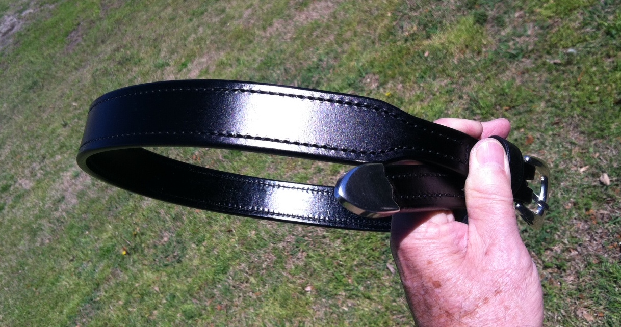

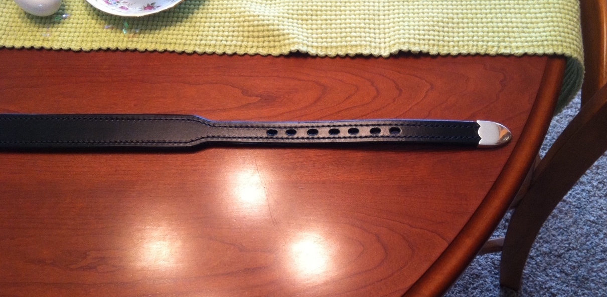

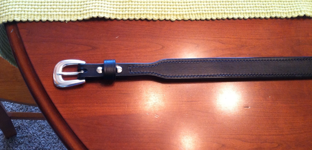

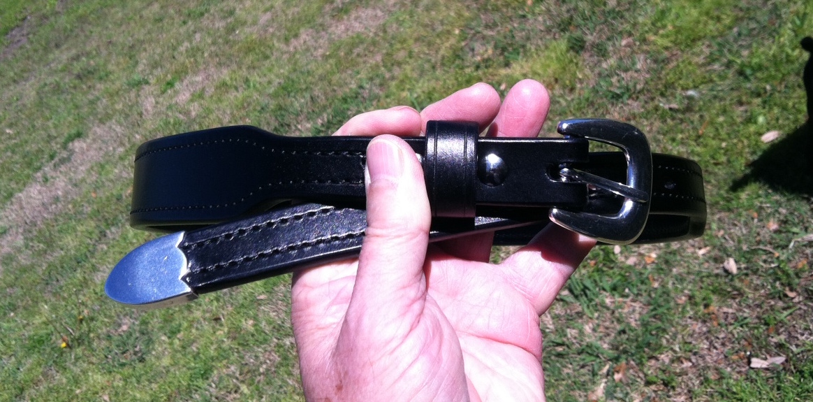

Posted (edited)
Instead of risking an entire belt, I made a five inch "belt" from scrap leather, grooved a stitch line and finished it as I would a normal belt. I changed the stitch length to seven stitches per inch and had a go with 277 on top and 207 on bottom. What do you think? Apart from the need to polish the bottom of the center presser foot and adjust for no marking of the leather, do you think the repaired Adler 205-374 is ready to rock-n-roll?

Hi Lucas! stitch length (or SPI in your country) is a matter of taste. Some old harness makers hand sewed bridles with 14 stitches per inch, the more stitches per inch the higher the work was regarded. In the beginning making leather works I thought long stitches was looking nice, now I'm leaning more the other way. Especially the saddle stitch look more beautiful with more stitches per inch, the stitches forms a better angle. To a certain degree more stitches are stronger too, as long as you don't over due it and perforating the leather totally. I often use Texas 346 (TKT 8) polyester thread with a Nm 230 LR needle (Schmetz, Singer size approx 26) on my 441 machine. Mostly my stitches are around the number 4 on the stitch length lever. That would be 4 mm stitch length of course, converted to SPI it would be about 6,25 stitches per inch. My 441 clone have enormous maximum stitch length of 15 mm. (1,66 SPI). It should not have more than 12 mm. max, according to the manual.  The first tripple feed Adler 205 was the 205 -74, built on the famous 205-64 needle feed. They added an extra shaft for the top feed to it. Your -374 where the second generation, first with the shuttle shims/spacer who allowed use of a larger needle. I do not remember the spec. on it, pretty much the same as the -370. You can easily find out going to the world of Dürkopp-Adler parts download  http://sew24.blogspo
There you will find what documentation who are available on it, if you haven't done so already. I think yours is very similar to the sub cl. -370; max stich length 10 mm., foot lift 20 mm. and max needle size Nm 300; with the largest shuttle shim. They sell 5 different such shims/spacers, for different maximum needle sizes. Your Adler where the first 205 who had this system, ensuring optimal clearance  between hook and needle at all the needle sizes.  I think your stitches look good now, white is always better looking on natural leather too. It's not "odd" That the stitches are crossed on the back tack; the needle will alway bend and take the easiest path. Try experiencing with other needle points too, see what you like the best. Now people tend to like what looks most traditional/old fashion, real leather; natural materials and craftsmanship. The LR needle imitates hand sewing, that's whats people really wants.
Tor
Tor
Workshop machines: TSC 441 clone/Efka DC1550, Dürkopp-Adler 267-373/Efka DC1600, Pfaff 345-H3/Cobra 600W, Singer 29K-72, Sandt 8 Ton clicking machine, Alpha SM skiving unit, Fortuna 620 band knife splitting machine. Old Irons: Adler 5-27, Adler 30-15, Singer 236W-100
I did not see that post before posting my long answer. I think your machine is ready to go now. Perhaps that was a bit to short stitches for the straight stitch appearance. It looks like it's made in a factory, if that's what you want, then it's good. This is pretty much up to what you like yourself (application and material thickness of course), I would have used a bit longer stitches for this straight seam (spear point needle). When stitches are angled like the LR needle, stitches would look ugly when they are to long. Straight stitches is a different ball game. The stitch quality look very good now.

Thanks, Tor, your feedback is appreciated. I am now interested in trying the LR needle, since my hand stitched belts have that traditional saddle stitch pattern. I lean toward the longer stitch length; especially for the heavier thread (346 to 415) I like the look of a little longer stitch length. I am trying to avoid the made in a factory look, so I will experiment more with the stitch length with these spear point needles. The documentation you mention for the Adler 205 series that is available online I have downloaded. I have most of the spacers for the various needle sizes. I used the service manual for the 205-370 as I was making adjustments to this machine. I appreciate your comments about the color of the thread. On the samples above (except for the finished sample) I used what was in the machine when I sat down to practice. I like the lighter threads on natural to light brown. On the finished sample above I used black since the edges of the scrap piece of leather were dyed black. I have been tempted a few times to return to hand stitching my work, but the encouragement of those on this forum keeps me at the task of learning to sew on a machine and repairing the Adler 205-374. Thanks again for your feedback. Very helpful, indeed.
I bet if you take a smooth faced hammer, and tap those stitches just a bit it will look even better. When I sew belts, I use a bit longer stitch length, but not much.
