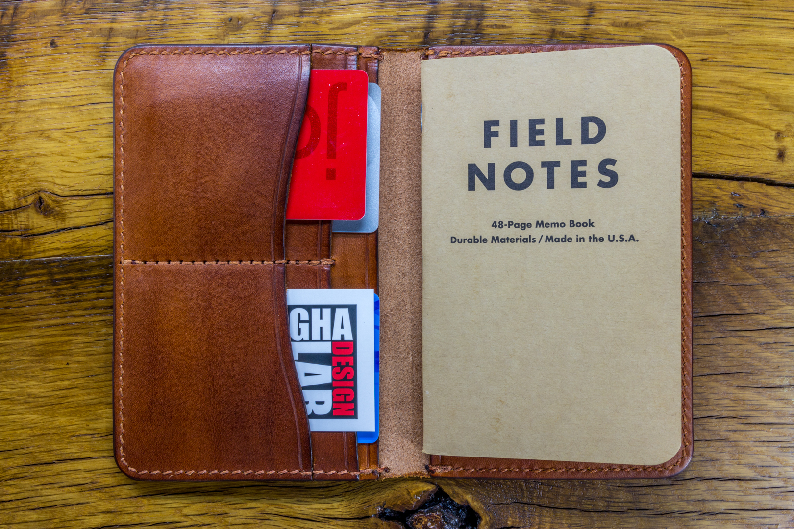

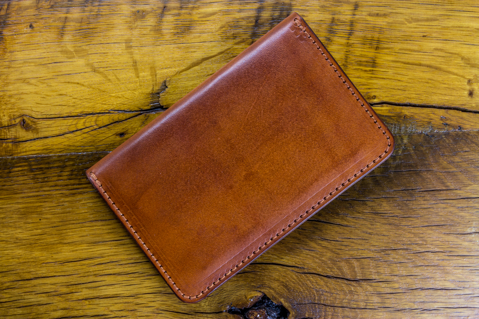

Members particle Posted May 24, 2016 Members Report Posted May 24, 2016 I made this cover a while back to fit a field journal insert, a few credit cards, receipts, and a pen, etc. I used English Bridle leather leftover from a previous project. Wish I had more of that stuff! Quote Eric Adamswww.adamsleatherworks.com | Facebook | YouTube | Instagram

Members particle Posted June 9, 2016 Author Members Report Posted June 9, 2016 Here is a couple other variations I made of the same travel journal. The first version had no built-in option for holding a pen. The second one included the pen holder. The third (originally posted) had a locking tab to keep the cover closed when the pen is inserted. Quote Eric Adamswww.adamsleatherworks.com | Facebook | YouTube | Instagram
Contributing Member JLSleather Posted June 9, 2016 Contributing Member Report Posted June 9, 2016 (edited) Those look pretty good, but you might back off the presser foot just a tad. Got an inconsistent "witness mark" along your edges (maybe you could crease it right there so it's consistent), and it looks like maybe your pocket got hung up on the machine (first photo pocket booger). Edited June 9, 2016 by JLSleather Quote "Observation is 9/10 of the law." IF what you do is something that ANYBODY can do, then don't be surprised when ANYBODY does.
Members particle Posted June 9, 2016 Author Members Report Posted June 9, 2016 If memory serves (I made these over a year ago), the one without a pen holder was made in one evening over the course of about an hour to test my pattern. I'm sure the leather was still damp from the dye when I sewed it. My machine is setup for sewing holsters and since I rarely make anything else, I don't like changing the settings unless absolutely necessary. I should have hand sewn them, but these were all just one-off mock-ups to test patterns prior to going on my website. Quote Eric Adamswww.adamsleatherworks.com | Facebook | YouTube | Instagram
