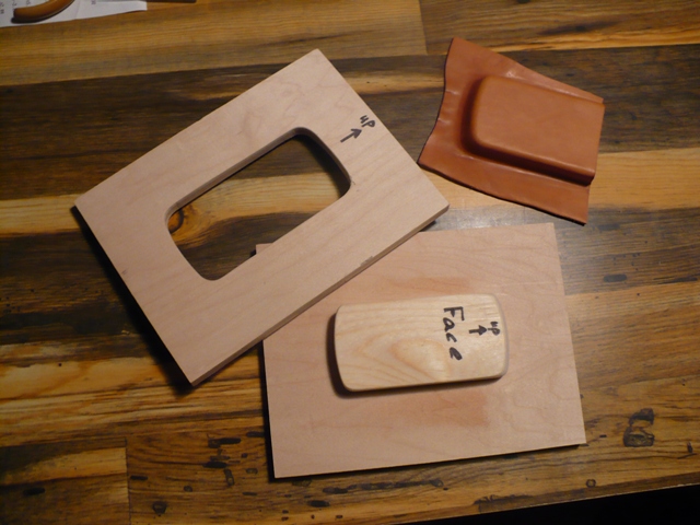

There are indeed a lot of different ways you can make a small case. Recently, I made two small cases for a police officer, one for his cell phone and one for his Leatherman. Another officer, who used to be a Tandy's manager, made a nice wooden form for me (see the picture below) cut exactly the same size as the cell phone. You can easily make a form the size of your mp3 like Kate mentioned out of wood or layers of leather.
Here's how I did it.
These three pictures show the wooden form and the leather which was stretched over it.

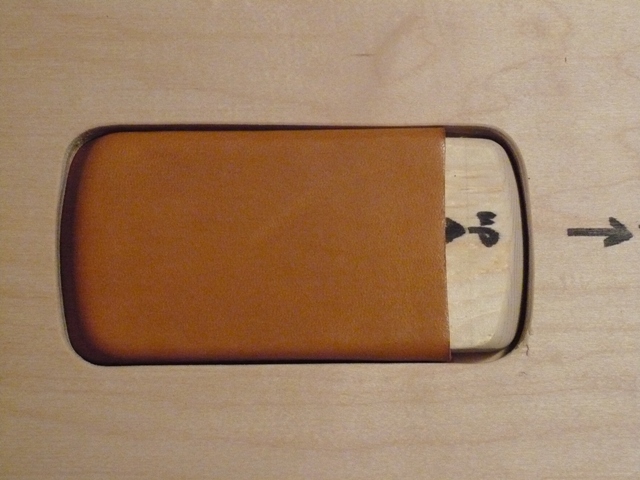

This is how I stretched the leather over the Leatherman.
Here the back piece is attatched, but not yet sewn. Notice how the leather is much larger than it needs to be in the end. Insert the form and make your stitch line close ot it, but not so close that you are pinching it too tight.

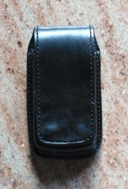

Here is the finished cell phone case.
I hope this helps.
