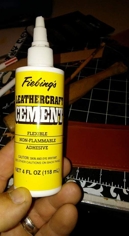

bikermutt07 Posted August 16, 2016 Author Report Posted August 16, 2016 Alright, I think we are ready to start the assembly. If you line up card panel "x" and "o" you will notice an offset where they stitch together. I'm assuming this offset helps the main body wrap around the card pockets. But, I digress. So, line the templates up with the pieces and mark your stitching holes. As a side note you can change the stitching up. More holes, smaller holes, whatever. Figuring out the right combination of stitch length, thread size, to needle size is practically a sub culture here. I tend to grab what I think will Work and do a test piece. We need to put a line at this spot so we can glue it up. I never see this glue mentioned here but I like it. It seems to be farely well set in a short amount of time. I resembles hot glue once it cures. I paint this on both sides. Very thin coat. Just put it on between the line and the stitch marks. Just give it a few seconds and then line up the pieces. I like to love on these for a second with my hammer. Quote I'm not paying 80 bucks for a belt!!! It's a strip of leather. How hard could it be? 4 years and 3 grand later.... I have a belt I can finally live with. Stitching is like gravy, it's only great if you make it every day. From Texas but in Bossier City, Louisiana.
bikermutt07 Posted August 16, 2016 Author Report Posted August 16, 2016 Now that we have glued our first piece lets try to stitch a line. What's great about this first line? No one will ever see it. This is the first time I haven't used my chisel. In the spirit of staying in the pattern, none of my chisel sizes fit the pattern. So, the way to make the diamond awl work with out the premarked diamond holes is like this..... Keep a flat edge of your awl parallel to the edge of the leather. You can see I messed up a bit at the beginning, but no one will see it in the end. Always make sure and tap your stitches flat with your hammer. Next step: Mark your holes on your main body. Do Not glue your little pockets to the main body before you mark the holes on the main body (only an imbicel living Louisiana would do that). After, and only after, you mark the holes in the main body may you glue the tabs of your top pocket to the main body. Quote I'm not paying 80 bucks for a belt!!! It's a strip of leather. How hard could it be? 4 years and 3 grand later.... I have a belt I can finally live with. Stitching is like gravy, it's only great if you make it every day. From Texas but in Bossier City, Louisiana.
