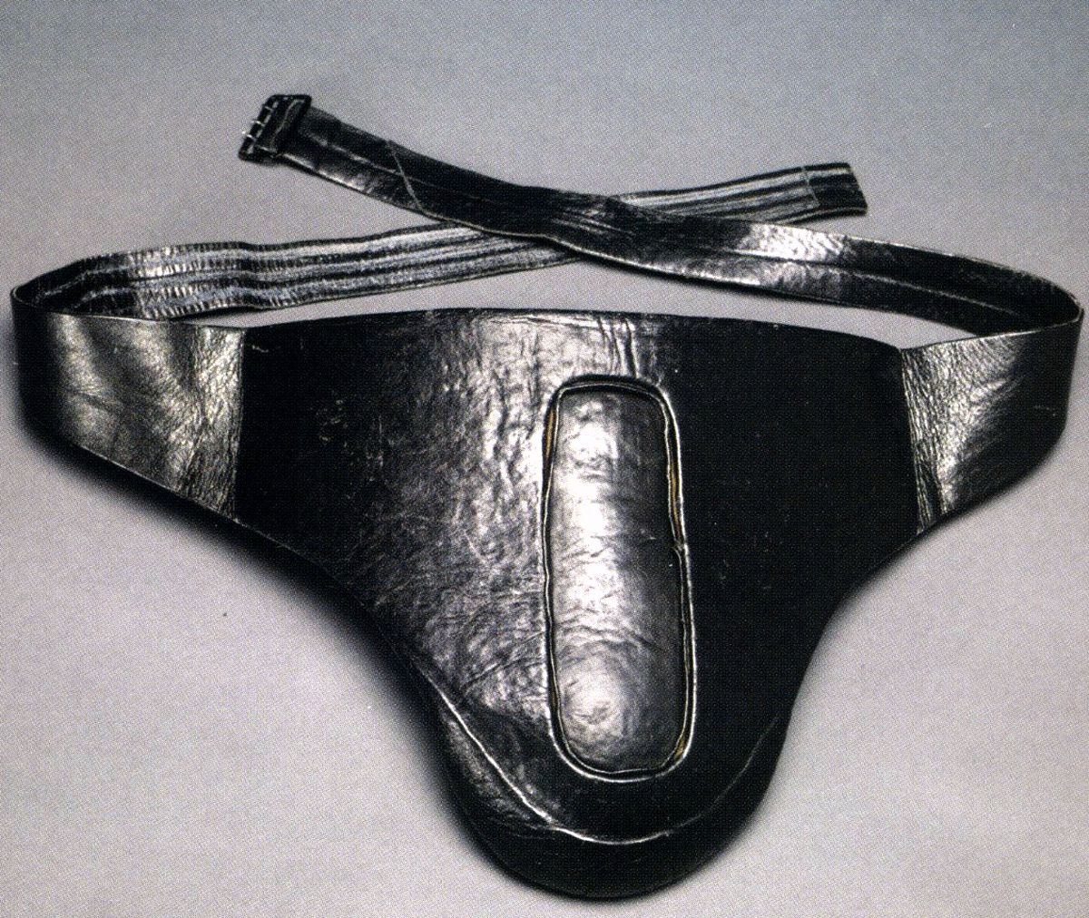

Members TheGoodSamaritan Posted February 21, 2017 Members Report Posted February 21, 2017 I'm trying to make a replica of Darth Vaders original codpiece from the 1980 movie Star Wars Empire strikes back. A codpiece is the part that covers the crotch. It's made from foam rubber covered with leather. I realise that the rubber foam underneath might be giving the lumpy structure and not the leather it self. It is made in the seventies. Can anyone see what type of leather it is from these reference photos? Cow, lamb, deer etc? What type of finishing etc? I don't know much about leather so any help you can provide about what type of leather this could be is very appreciated. http://s6.photobucket.com/user/starwarscollector/media/PropReplicaForum/ESBPromotieposter.jpg.html Quote

Members CaptQuirk Posted February 21, 2017 Members Report Posted February 21, 2017 Ok... it isn't for taking "Casual Fridays" to a new level then? I just had to ask... You can never be too sure these days As for the "leather", it is likely upholstery grade Naugahyde, which is a very rare and hard to find material, since the number of wild Naugas has diminished greatly. If you insist on leather, I would go with 2 oz milled. Quote
Members Mattsbagger Posted February 21, 2017 Members Report Posted February 21, 2017 The lumpy look is probably texture on Chome tan leather. A lot of chrome tan has a texture in it to hide imperfections in the leather. I don't see any burnished edges they appear all rolled/turned to me. As to making it. I got nowt. Good luck. Quote

Members TheGoodSamaritan Posted February 21, 2017 Author Members Report Posted February 21, 2017 (edited) On 2/21/2017 at 1:36 PM, Mattsbagger said: The lumpy look is probably texture on Chome tan leather. A lot of chrome tan has a texture in it to hide imperfections in the leather. I don't see any burnished edges they appear all rolled/turned to me. As to making it. I got nowt. Good luck. Expand Making them is not a problem. I've made a few that turned out pretty good. Sold those. I overlayed a reference photo in photoshop and they line up perfectly to the original. The only thing I have to nail down is the texture of the leather. I live in a small town in sweden so my only option is to order online. The only leather I've found thin enough is lamb leather. It needs to be thin, about 2 oz for it to look good. Also not too stiff. However I don't know what to look for. I don't know the correct terms for the type of finish. It doesn't have to be the same leather but similar. So chrome tan and someone mentioned milled leather? Edited February 21, 2017 by TheGoodSamaritan Quote

Members CaptQuirk Posted February 21, 2017 Members Report Posted February 21, 2017 Here is the thing about costumers and sfx people, to add to my "upholstery grade Naugahyde" statement. Even on a big budget film, there are lots of places the money needs to go, and effects people are left short funded. So, it is not unusual, that the original was made from scavenged pleather from a sofa or la z boy recliner. They used a tape recorder for the mech stuff on his chest. That cod piece certainly was not leather though. Quote

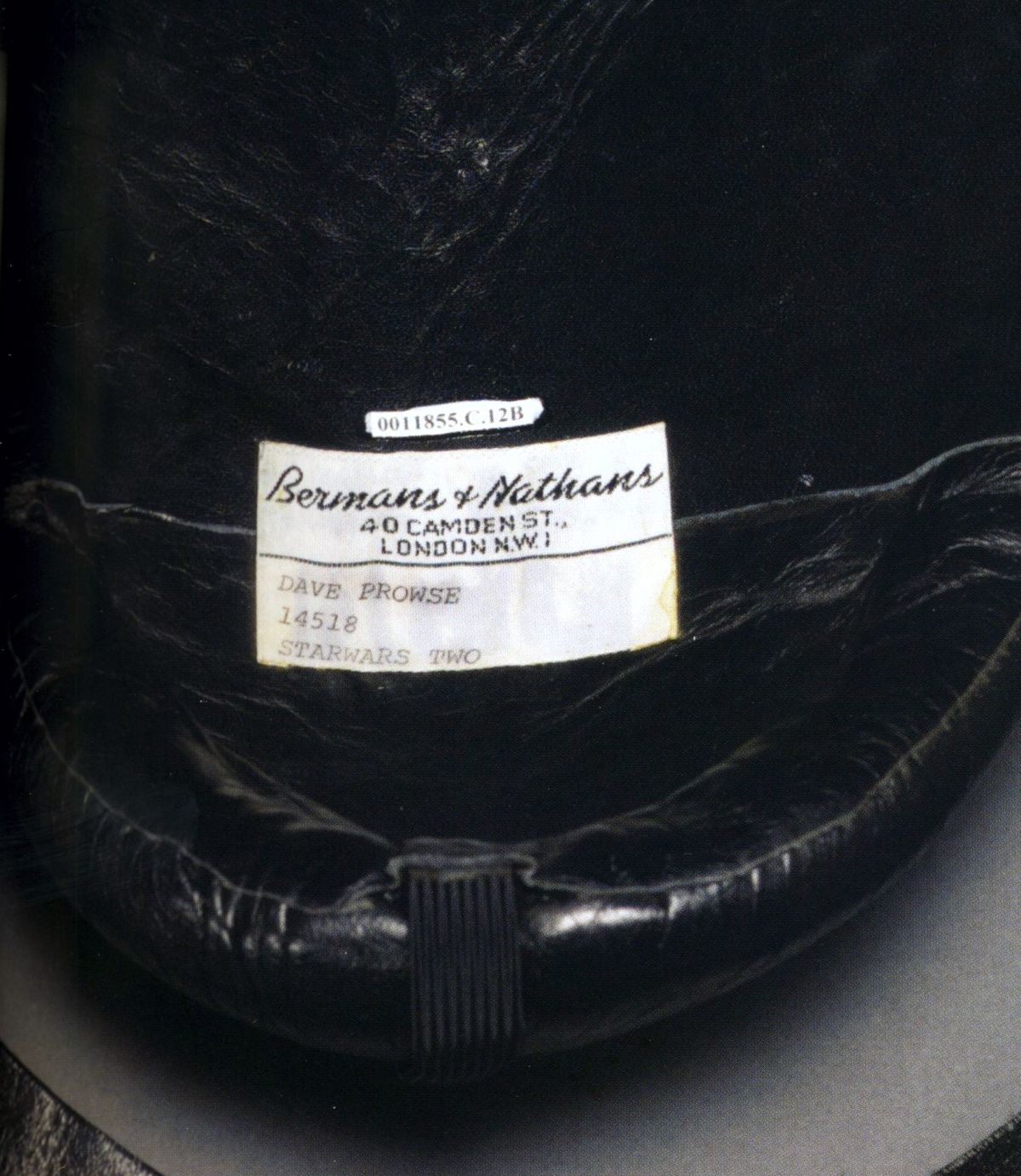

Members TheGoodSamaritan Posted February 22, 2017 Author Members Report Posted February 22, 2017 Here is a Picture of the backside: Are you sure this is naugahyde? Quote
Members CaptQuirk Posted February 22, 2017 Members Report Posted February 22, 2017 It's hard to tell from these pics, but I'd be willing to bet it isn't leather. But, since they were kind enough to stick a label in it, track them down and ask. On 2/22/2017 at 6:07 AM, TheGoodSamaritan said: Googled naugahyde. It's pleather. I thought it was some kind of animal haha :D Expand Sorry, I'm like that though... always leave them scratching their heads Quote
Contributing Member fredk Posted February 22, 2017 Contributing Member Report Posted February 22, 2017 I would use 1 to 1.5 mm upholstery leather for this. Sewing; place two shaped parts grain to grain, sew edges with a saddle stich, turn inside out, pad out with wadding. Fold over and glue the strap lengths Can't see signs of stiching around that bit on the front. For that I'd cut out the shape on the main piece and glue the insert in place on the inside, pad it out a bit with wadding, then glue a thin lining leather, eg pigskin, over that wadding and the insert part. Assemble as above. If the original was leather and the insert on the front was sewn; I suppose it was done by cutting out the area, leaving an edge to fold inwards, the insert and welt were sewn to that edge [grain to grain], folding the sewn part against the inside of the front panel. That would keep the stiching hidden Quote Al speling misteaks aer all mi own werk..

Members billybopp Posted February 22, 2017 Members Report Posted February 22, 2017 The "herd of naugas" joke is an oldie but very much still a goodie! Marketing departments started actually advertising naugahyde as a "feature" in the 70's - before that it was just vinyl. I suspect the change came about to set newer more durable vinyl products apart from earlier products that became brittle after a few years. Vinyl is pretty useful even for leatherworkers. It's a great cheap material that behaves much like leather, and can be used to make mockups for stuff. I'm pretty sure the original is at least partly vinyl. If you look at the piping around the center piece you can see a bit of very light color peeking through. Since garment leather is usually mostly struck through, we wouldn't see that. The inner liner does look like it might be leather, however, since that does look right for chrome tan (a bluish color). I'd also guess that there's some sort of bag stiffener behind the main front piece to help keep that curve. There's also some sort of stuffing material there to give it thickness, particularly around the bottom edge and behind the center piece to give it fullness. The piping around the center piece has either no cord or very thin cord. Outer piece, piping and center piece are probably glued and sewn from the back side. Front and straps appear to be a single piece of leather, so could take some creative design to get the straps folded over as in the picture. (forgive the comments about a codpiece with stiffener and stuffing please - I know it's hard to believe that a bad-ass like Vader might need stuffing and stiffening - but then again he had a lot of medical problems - I guess the force can't do everything). Even if the original is pleather, there's no reason why you can't make yours from real leather! Goat is pretty nice to work with in garment weights, but others are fine too. The surface finishes on garment leathers can vary greatly, so your best bet would be to look at some in person to find the texture that you want. I have some that is so smooth and shiny that it looks like vinyl, and other with various surface textures and amounts of gloss. Oh. And just to make y'all jealous - I got meet James Earl Jones a couple of years ago when he did a play on Broadway. His voice is even more amazing in person, and presence on stage is phenomenal. Bill Quote

Members kbcubed Posted February 23, 2017 Members Report Posted February 23, 2017 The surface of the cod piece looks like buffalo. The straps likely are lamb. Quote

Members TheGoodSamaritan Posted February 23, 2017 Author Members Report Posted February 23, 2017 Is there a way to make the "piping" without actually folding leather all the way through? I want to fold the leather to make piping but is there a way to remove the bulk so the folded leather is as thin as only one piece of leather? Quote
