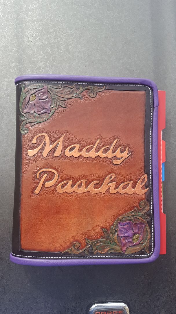

The best I have used for leather so far is Angelus brand acrylic paints designed for use on shoes and leather. Most even come with a brush built into the lid, which is nice when you are painting letters and such. Angelus colors tend to be more vibrant and cover better with less coats. I am sure there are other brands that work equally as well, airbrush artists use a lot of water based acrylics, so I am sure there a lot of good brands marketed to those folks as well.
Here are a few of my Angelus paint jobs
