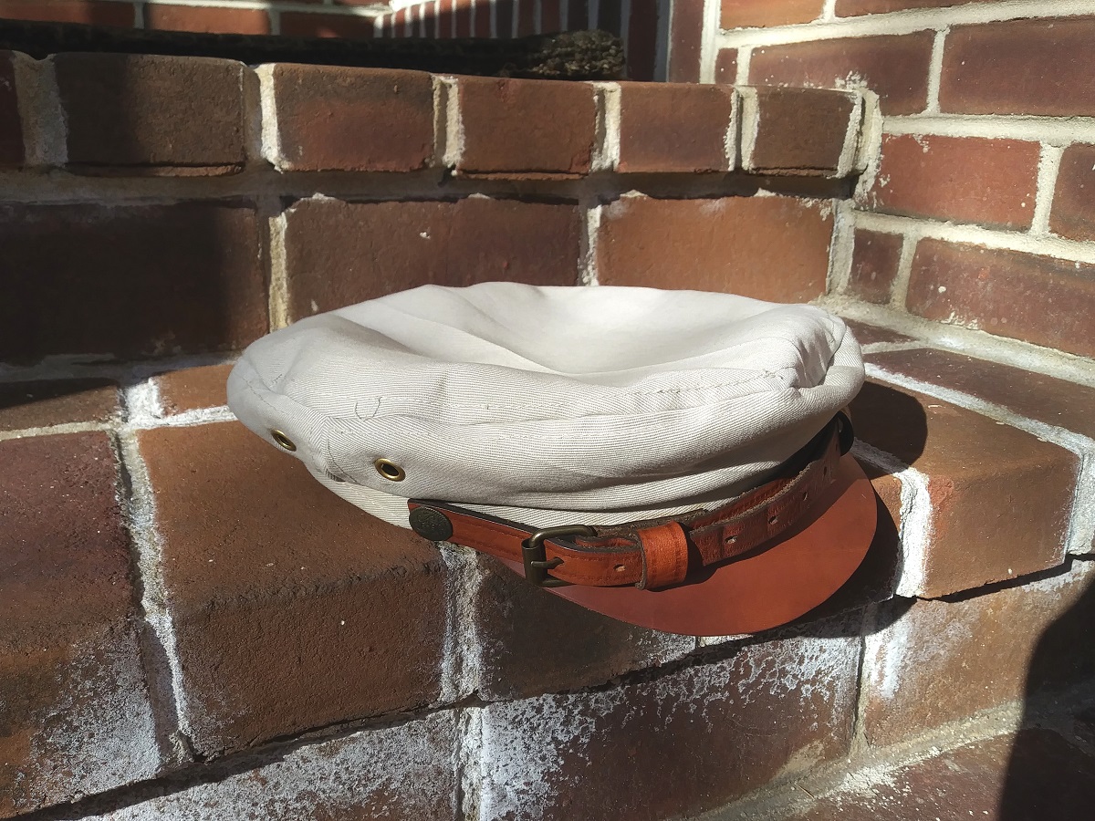

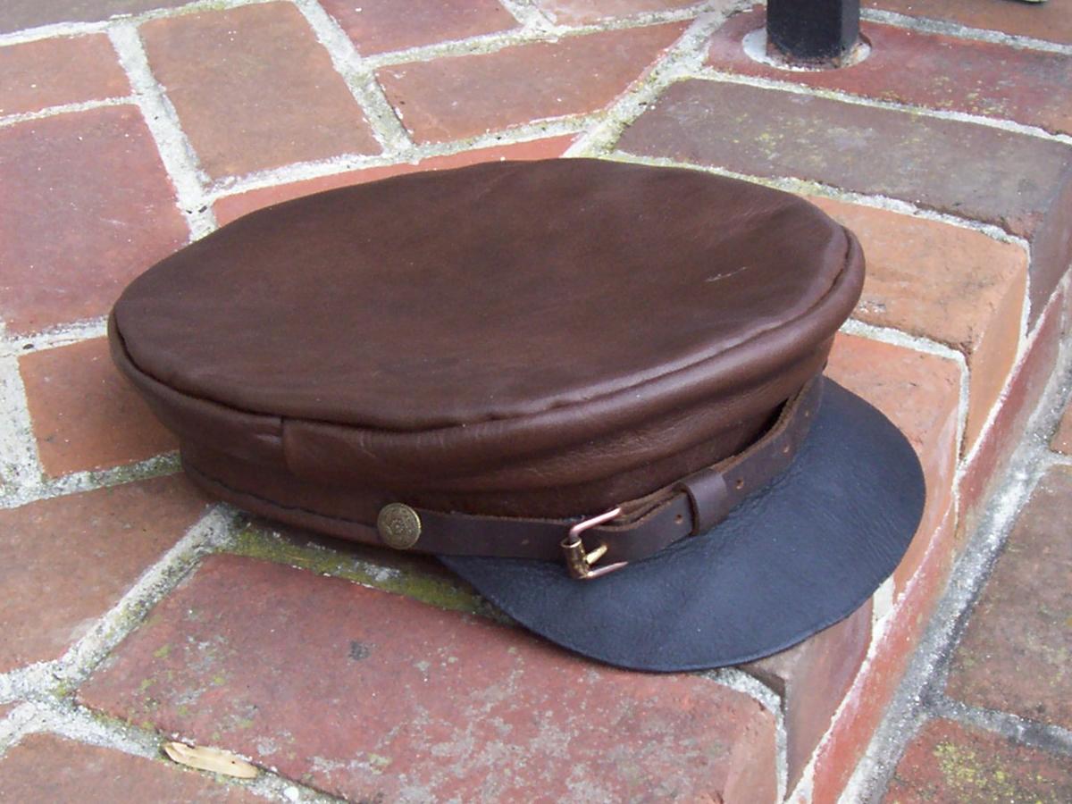

Members DanDSilva Posted May 28, 2021 Author Members Report Posted May 28, 2021 (edited) So, what I've found over the last few years is that these visors don't really need molding as long as the inner edge is just concave enough. When it's stitched into place, it'll assume a downward curl naturally. Here's an early attempt: This one has a less concave inner edge, so it curls down more: As far as the finish goes, I think just an oily/waxy water-resistant finish that's still flexible is preferable to a hard acrylic finish that might crack when creased. The first one is made with some Crazy Crow blacksmith side leather; the second is just light/midweight veg-tan with oil, Sno Seal and conditioner. Edited May 28, 2021 by DanDSilva Quote
