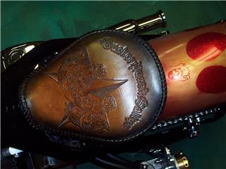

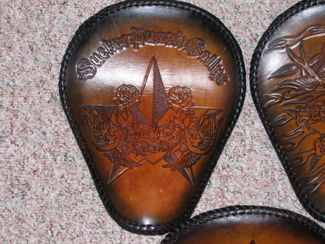

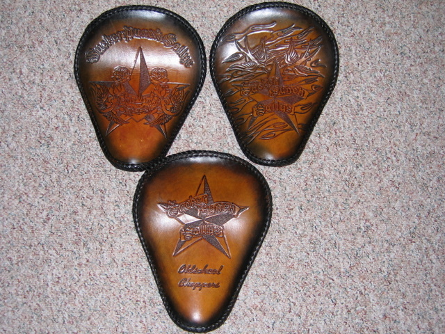

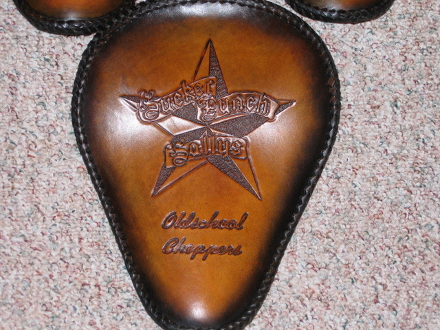

I tried my two-tone dye process on my latest production seats. We'll see how they like them.

Love it Dave. Can I ask how you get that 2 tone shading. I have been trying to get that look on projects, but it never works. What's the secret?
Major,
I used one of the preval spray bottles to apply my stain....this was an experiment for me as I usually use my spray gun on my compressor.....it was very convenient; but not as fine a spray as my 100 psi spray gun. I guess that was to be expected. I spray the entire seat buckskin and then begin to darken the stain with black as I get to the edge....the final spray around the edge is straight black. After spraying I start applying the anitque paste.....I use Sheridan in the center and work toward dark brown around the edges....I keep applying and wiping and re applying until I have the look that I like. There are a lot of variations on this, Instead of darkening the stain with black you could darken with saddle tan and medium brown and have a much redder look to the leather. I hope that helps.
