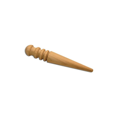

Members Mike1261 Posted May 28, 2019 Members Report Posted May 28, 2019 Hi folks I've been reading all about burnishing for quite a while and have been trying to find my technique for a leather bracelet. I bevel, sand, then use liquid saddle soap and a hand burnisher. The result comes out looking slick and smooth and shiny. But after a day if wear some of the fibers start sticking out a bit and looks sloppy. I read a post on here where someone followed up the saddle soap burnish with a 50/50 mix of Paraffin Wax and Bees Wax and burnished it again with the wax. So I melted it up and mixed it 50/50 and tried that method. The result is a decent edge that almost certainly will hold up, but there is no gloss to the edge at all. I take the excess off with canvas and it looks nice but dull. If I try using some elbow grease with a microfiber cloth the edge kinda dries out and looks awful. What does one do to buff out a paraffin/beeswax burnish and make it look as nice as a saddle soap burnish does? I want the durability of the wax but the slick shine of the saddle soap. Thanks! Quote
