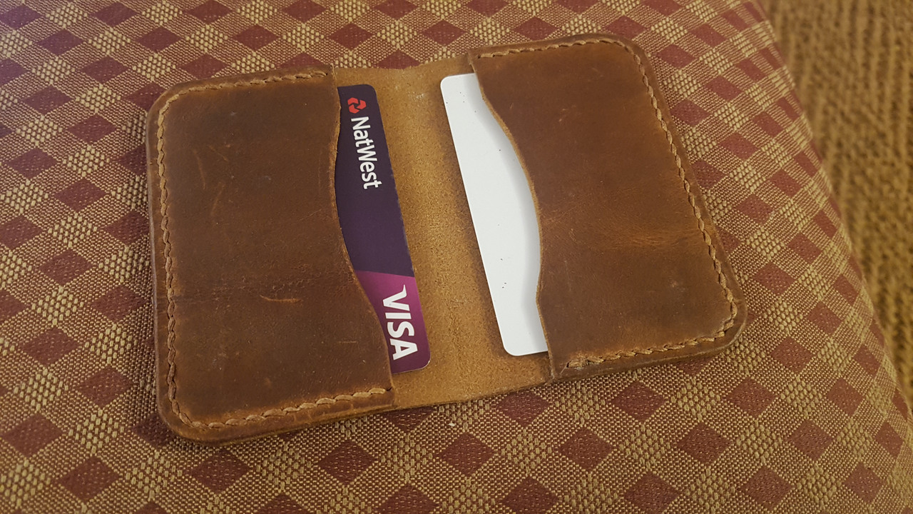

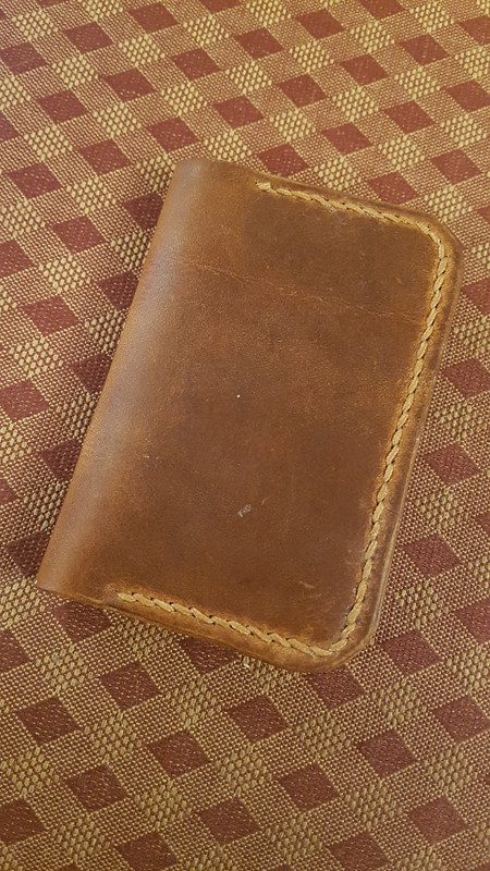

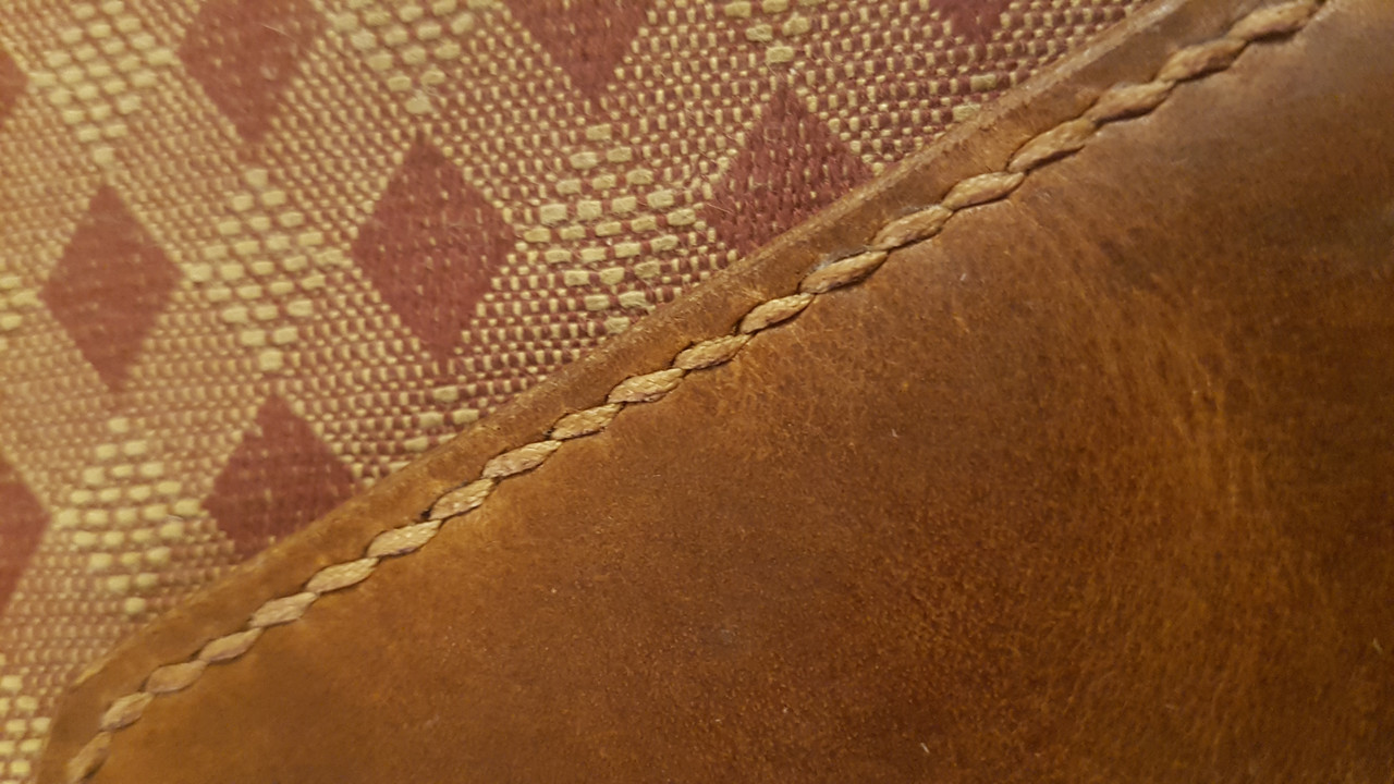

Members hughlle Posted January 8, 2020 Author Members Report Posted January 8, 2020 Well I figured I'd keep it basic, and remove the inner layer that prompted this thread. I know that I should have just stitched all of the way around, but was just playing about really. Learnt a few things in the process, but I still ended up with a usable item. I'm quite pleased with my stitching for a first attempt. Thanks for the input though, I might be trial and error in my approach, but its still nice to be able to see what other people think is right. Don't have my tokenol yet, so just used some homemade waterproofing wax on the edges (beeswax, terpentine, boiled linseed oil) Quote
