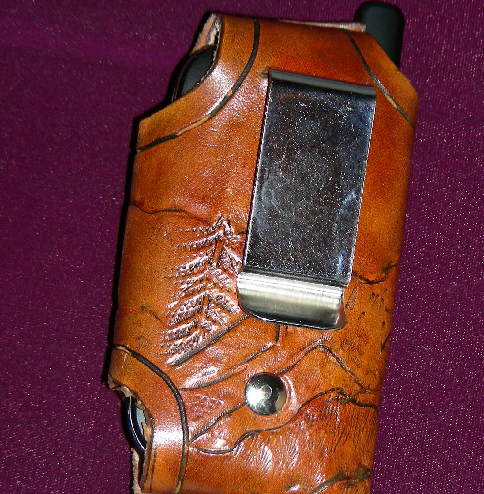

Here's a case for my phone that I mixed british tan into Bicks4. Followed that with brown antique and Super shene(probably not needed). I do like the more even dye coating I get by mixing. I don't get the streaking that I used to. I've done a few other projects this way but, didn't photograph. I don't like this type belt clip because I had to line the back.

Nice design! That's why I love the Bick's mix too! And no you didn't need the supersheen because the Bick's will soften and oil the piece to the point that it is real water repellant.
I really like it on cheaper (lighter) leather. It NEVER looks dark and rich after I oil it so I use the dye/Bick's on a lot of projects to get the rich leather look before I antique. MOst of the albums look like expensive Herman Oak or W&C leather.
It's not too late to get a good burnish on the edges. Would make it look even nicer!

Pete, I burnished last night after reading your reminder. Sure see a lot more in those LARGE photo's.
