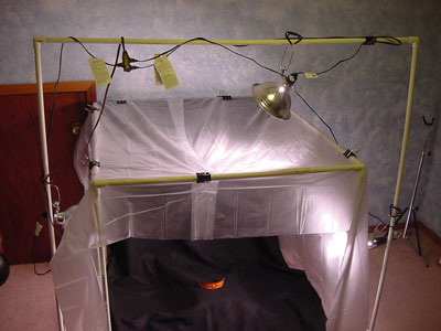

Members CitizenKate Posted September 15, 2007 Members Report Posted September 15, 2007 (edited) For those of you not familiar with this, it's called a light box, or a "soft box". The idea of it is, when you're photographing your work, you want your subject fully saturated with strong lighting from numerous angles, to minimize shadows. But the lighting needs to be "softened", or diffused, to reduce glare. The method JustWakinUp shared is a great way to build a smaller one. I needed a larger one to accommodate my large game boards. So I built this one out of PVC and vinyl shower curtains. You can use this method to make it any size you want. The nice thing about this one is, I can tear it down, fold it up, and store it in the closet. It was a little more than $5, but it's also quite a bit larger than the one in the tutorial, as well. I think I spent between $30-40 for the whole setup, including the lights. Kate Edited September 15, 2007 by CitizenKate Quote

Members Romey Posted September 15, 2007 Members Report Posted September 15, 2007 (edited) Here is a decent cheap light box. The WHOLE key is lighting, your not so much trying to soften light but diffuse it. Type of bulbs and wattage make a HUGE differance, Get daylight bulbs or simply use natural sunlight, 11 am on clear day works best for me. If the thread goes farther I can mention f stop speed, white balancing ones camera ect and also why daylight bulbs(due to color spectrum) Knives are no question most difficult thing to photograph due to angles, severl dimensions of angles ect round and flat shapes. Use of reflectors take away alot of nasty shadows as well. Edited September 15, 2007 by Romey Quote Romey Cowboy inc highcountryknives
Members CitizenKate Posted September 16, 2007 Members Report Posted September 16, 2007 Romey, that's a pretty clever solution, as well. Amazing, all the things you can do with PVC pipe, eh? Kate Quote
