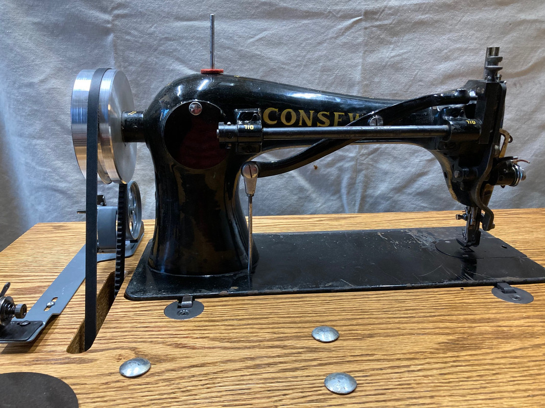

The Consew was purchased rusted solid on a sketchy home built table with rusty steel legs and a rough plywood top.  I scrapped the top and got a solid core door slab and remodeled the steel from simple square design to a trestle with better knee clearance.  The foot pedal was a leftover from a 132K6 foot lift that I removed and replaced with a knee lift.

@sandmanred Love those welded aluminum legs and that huge pedal on your table!
