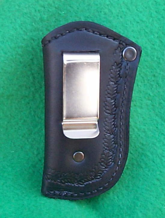

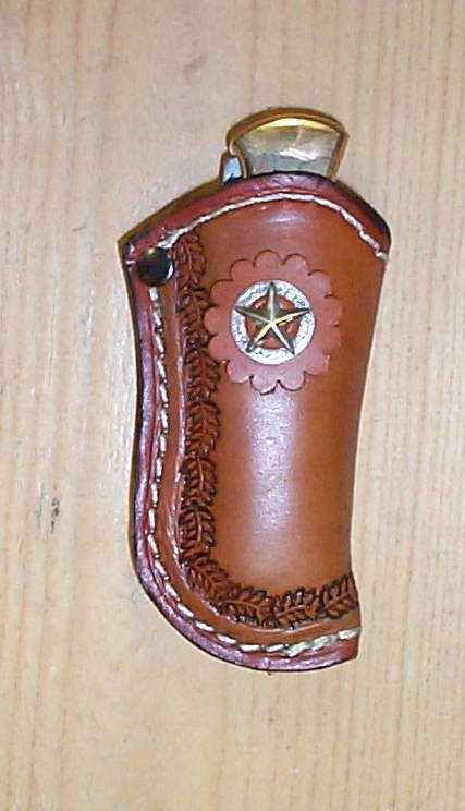

Members TimberWolf Posted October 7, 2007 Members Report Posted October 7, 2007 (edited) Hey all, Two open top knife sheaths. Nothing fancy, just functional with minimum trim. Pattern designed by me. This size fits a smaller folding knife, like the Buck 112, or most others that are 4.25 " tall. They are fully lined and have a sturdy belt clip. The black sheath was made in 45 minutes- start to finish. thanks for viewing! Tim Edited October 7, 2007 by TimberWolf Quote Tim Wolf, http://timberwolfleather.com

Members TimberWolf Posted October 7, 2007 Author Members Report Posted October 7, 2007 Thanks Jim ! No hand sewing,..I use my Artisan 3000. Tim Quote Tim Wolf, http://timberwolfleather.com
Members TimberWolf Posted October 7, 2007 Author Members Report Posted October 7, 2007 Hey Alex, thanks! Yes, I use a 3/8"welt. It keeps the sheath from being too tight. The black one is black latigo, so that cuts out any hand dyeing time. Tim Quote Tim Wolf, http://timberwolfleather.com

Members Don Posted October 8, 2007 Members Report Posted October 8, 2007 Great job Tim. I really like the shape of your knife cases...gives a nice stylish look. I use black latigo also when the project needs to be black, but if you ever have to do a lot of stamping or floral tooling you may want to give black skirting a try. This is a vegetable tanned leather just like tooling leather but it is dyed black. I have found for tooled projects this works better for me because it cases well and holds the stamping better. Latigo works well also but sometimes (depending on the stamp) I can't get the depth that I want in the stamping. Looking at your shealths makes me think I need to keep up with style and rework some of my shealth and scabbard patterns. Great job. Quote
Members skipj Posted October 8, 2007 Members Report Posted October 8, 2007 A couple more questions: the welt is 3/8 wide? How do you keep the rivit on the belt clip from scratching the knife. Same question about the concho fastener. SkipJ Quote
