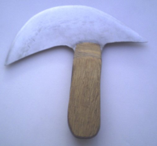

ferret Posted February 9, 2008 Report Posted February 9, 2008 I made my own from an old circular saw blade. It doesn't look too pretty but it feels comfortable to use and it works. Cost 25p (about 50c) and a days work. Quote
Members william Posted February 9, 2008 Members Report Posted February 9, 2008 Ferret I really like yours and the saw blade idea is great. Thanks for sharing. Quote
Members rawhide1 Posted February 9, 2008 Members Report Posted February 9, 2008 Ferret Great idea I was wondering after cuting out and grinding. Does a fella have to retemper. Thanks Mike Quote
ferret Posted February 10, 2008 Report Posted February 10, 2008 Got the idea from an old pslac newsletter (july 96) available here http://pslac.org/table_index_rawhide.htm . Re-tempering is fairly easy, just apply heat evenly with a blowtorch about an inch back from the edge until the steel turns brown/purple (260 c), then put it in a bucket of cold water. I used a 7 inch diameter blade and made a "tradional" round knife as well. Quote
