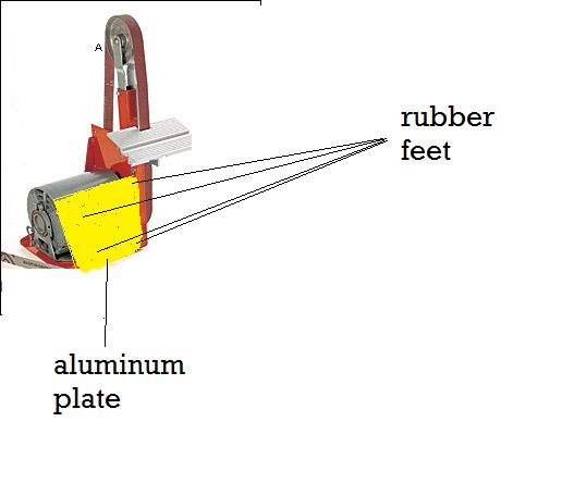

I used feet from here:
Amp Feet
http://cgi.ebay.com/Set-of-8-Rubber-Feet-G...93%3A1|294%3A50
See the attachment for a very crude rendition of the plate I used to mount the feet so the sander could be laid down. If your really gonna apply a lot of pressure, you can hang the belt attachment over the bench and use a clamp to hold it down, Or drill a couple holes in the foot plate and then mount some bolts with wing nuts through your bench. That way you can unbolt it quickly to stand it up if needed.
If you have any questions let me know.
