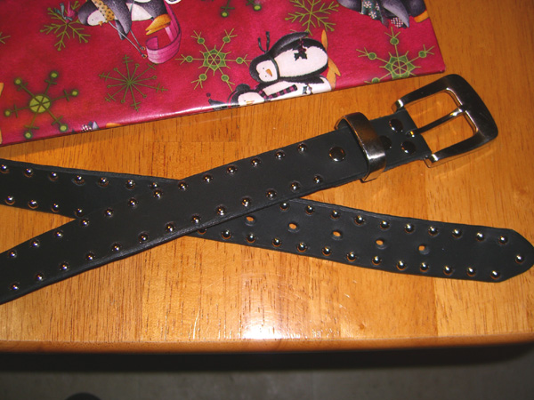

I had some time this weekend so I made up three projects to be given as Xmas presents for friends. One was a matched belt and wristband set; another was a wide belt for someone who wanted a simple brown belt with a fancy buckle, and the last was a replacement belt for my friend Liz's blingy spotted Harley Belt that broke at the buckle sending her into a tizzy.
For the first, I had some old Nature Tand leather that I cut into straps then I sanded down the fuzzies on a drill press drum sander. The brown belt got some water-based dye and Super Shene. The edges got burnished and Edge Koted. I took this buckle with an agate in the center and coupled it with the simple brown belt as requested! LOL!
The second... belt/wristband set... got a triple oiled & rubbed finish and was stitched with 277/207 poly. The belt hardware is a stainless steel roller buckle with Chicago screws. The wristband has 2 line 24 snaps. I gave them a light wax burnish with the Sampson burnisher to smooth out the fuzzies on the edge. I didn't put any edge coating on because I wanted it more natural.
Liz's belt was made from some utility side I had lying around. I used my Heritage Spot Setter (for the first time) to bling it up and put some segma snaps on to hold in the keeper et voila! No finish was needed.
I hope the recipients will like them.
Liz got her's last night at our Christmas party and she was thrilled cuz she loved her old broken blingy belt so much. Now she has a solid replacement. The new belt wasn't really all that good technically but then beggars can't be choosers. The spots were larger and the leather was much more substantial so she is a very happy camper!
I did enjoy getting a chance to fool around making these projects!

Nice work, Bree! I have a question, though. I've tried using that white poly thread a couple times and I couldn't get it to not come apart. How do you tie it off so it will not come apart? Thanks.
I cheat. A little dab of FabriTac glue to the ends helps keep it under control. Use a medium size needle to pickup the glue and "paint" it in without being visible (like the fly tying trick with clear nail polish).
I also lock the stitches 3 back and one forward which gives me a long time before I'm in real trouble. The best stitching is hand stitching but I'm WAY too lazy to do a belt by hand!!! So my Artisan 4000 and a tiny bit of treachery.
On the white poly... Steve over at Artisan has been wanting me to use their Natural Linhanyl nylon. He even sent me a spool to test. They are top flight over there at Artisan and I love Steve. But I still like the poly for this kind of project. It looks whiter than white. It wears very well especially if it's outdoors a lot. And it sews beautifully.
I don't think there is ALL that much of a difference between the bonded poly and bonded nylon. If Steve had the white Nylon, I might have gone with it and I would feel fine about it. I have about 20 pounds of various color nylon threads in #69 and #92 so it's not like I have anything against nylon. But I do like my white's looking very white.
The Natural looks kind of dingy white to me. There are some projects where that may be better than the pure white. And the difference isn't huge. Many folks wouldn't even notice a difference. I know lots of people PREFER the Natural. I just fall on the other side of the fence I guess.
I did get some fraying with the 346 poly as well as with the 346 Linhanyl. I think I may have a little microburr on the needle bar thread guide. I'm going to rouge up some thread when I get a chance and run it up and down that guide and smooth it out. I sized down to 277/207 and it solved the fraying problem teporarily.
