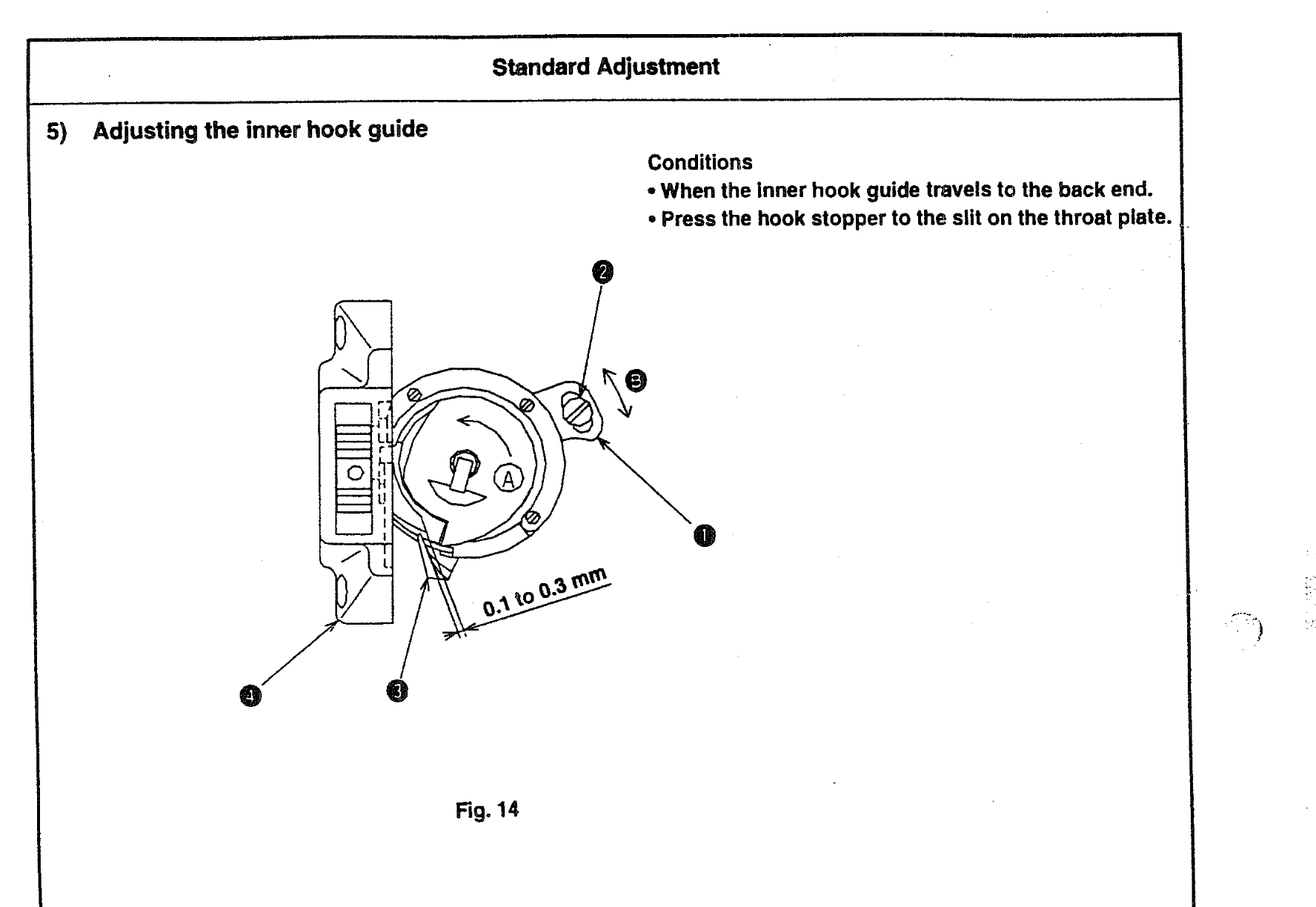

Seems I broke my Juki-LS-341, again... (Bobbin Shuttle)
friquant replied to Yoshi888's topic in Leather Sewing Machines
Here's the image from the engineer's manual. I don't bother with measuring this adjustment---I just make sure the latch opens far enough to allow thick thread pass through, and make sure the latch doesn't bind. By the way, it's the needle thread that goes through the latch, and the latch should open to allow the needle thread to go through as soon as the needle thread is ready. (Otherwise there will be some popping sounds as the thread gets forced through a closed latch) - Today

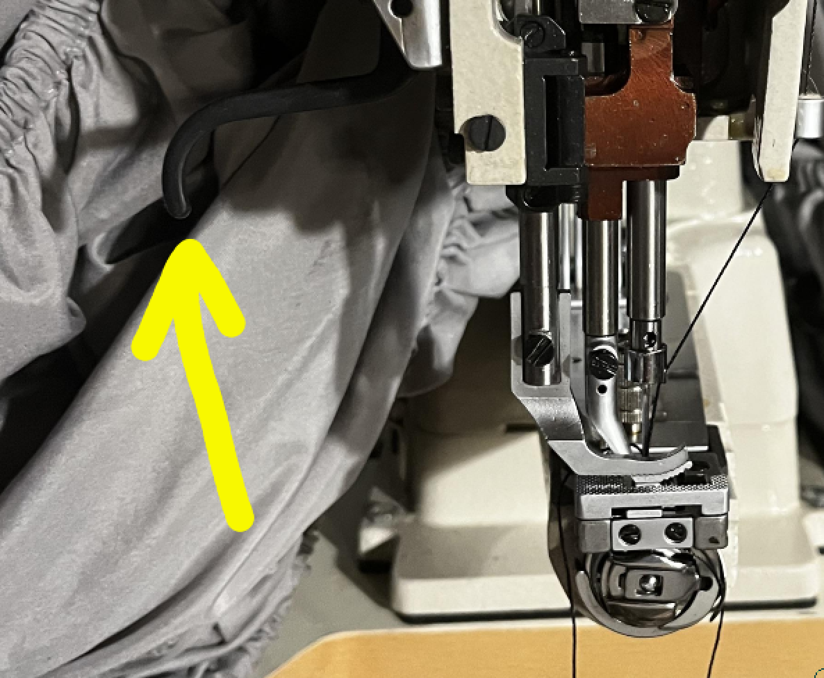

Hello, I own and have yet to operate my ikonix ks335a industrial cylinder arm sewing machine. Through this website somebody told me it’s a clone of the pfaff 335 cylinder arm industrial sewing machine. It is and I can’t wait to start sewing. However I have a problem, I can’t figure out how to raise the height of the presser feet. I know I can use the foot pedal to raise and lower the presser feet. But to permanently raise the presser feet is maybe 3 or more step process and may also include tension adjustment. Can anybody please tell me or show me a video that shows me how to raise the presser feet in the best way possible. Because I even emailed Ricoma which is where I purchased the machine and have got emails back with people responding with videos of different machines. It has been nice getting at least a response back from the company but not a good answer. So my advice as of now is if your going to purchase a similar machine order one through a small company. Because your going to have questions about the machine and who better to get answers from a smaller company who sells industrial sewing machines but has people who actually are using the same sewing machines that they are selling. please help and thank you!
Wizcrafts replied to Yoshi888's topic in Leather Sewing Machines
That part is known as the "latch opener." It should be set to pull back on the bobbin case as the thread goes around it, then let go after the thread knot is pulled up past the notch in the throat plate. There is a small amount of wiggle room in that cutout for the little tab on the bobbin case/shuttle to move forward and backward. Pulling it back at the right moment frees the thread to go up without hindrance. It should not be set to pull back hard against its stopped position. Leave a tiny amount of clearance at the pulled back position so you don't break anything or wear out the pulled parts. -
