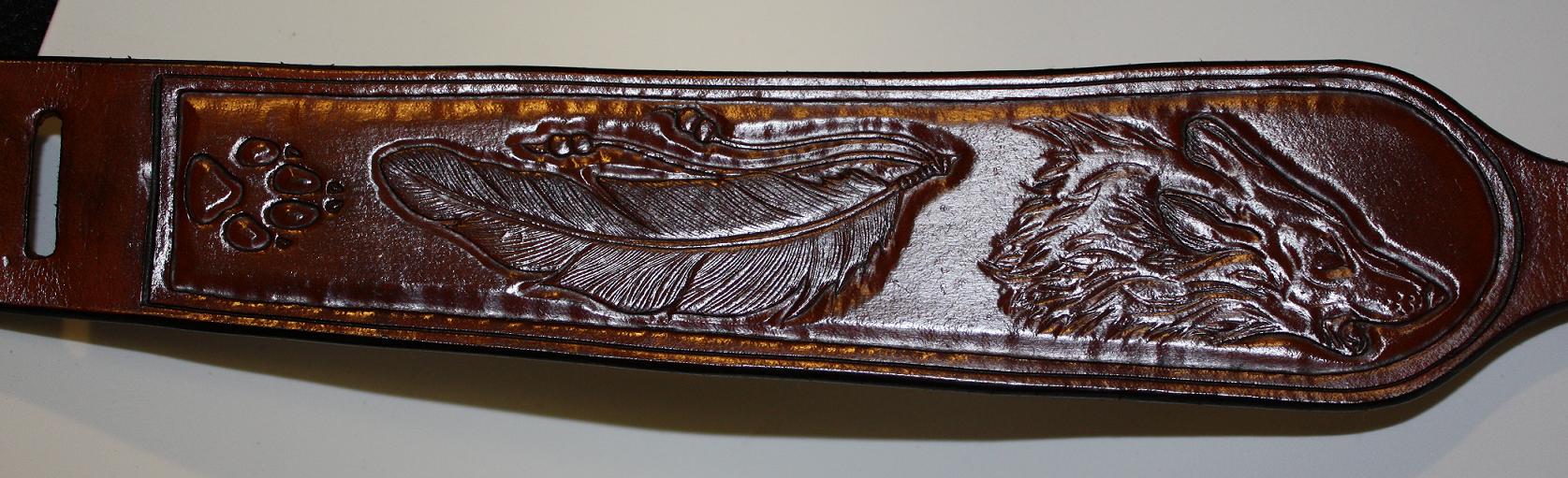

MADMAX22 Posted January 13, 2009 Report Posted January 13, 2009 Working on another rifle sling. This one I was trying for a old style look to it. The dye didnt come out as even as I would have liked but over all Im pleased with it so far. But when I finish (still gotta sew on the padded portion and put it together) Ill probably try to pawn it off on someone at work lol. Got the wolf image online, I drew up the feather and kind of free handed it on the leather except for the outline, and got the wolf print online. I was gonna use my hair tool but I still cant get any good results with that thing, so I just used the swivel knife for everthing, did alot of molding with the the modeler spoon or whatever its called. Ill post another pic when its all finished. Sorry for the bad pics I really gotta get one of those white boxes built. Quote
Members jbird Posted January 13, 2009 Members Report Posted January 13, 2009 Great job Max I love the dye chose and the art work the only thing I would say and take this with a grain of salt but looks like a smothing spoon could be used to nock down some bevel marks and I say that with backing because I have had a problem with the smooth bevler in that area. Josh Quote Josh Dusty Chaps Leather & Seven O Saddle Shop 801-809-8456 Keep moving forward! On a horse. Hebrews 4:12 My link
MADMAX22 Posted January 13, 2009 Author Report Posted January 13, 2009 Thanks Jbyrd and yes I need to improve on the beveling. I get most of the little guys smoothed out but the larger underlying bumbs dont smooth out as well. I definatly need more practice with working with the carving/stamping tools. I got into doing work for a while that was simple cases that didnt have any art work on them. And Im allways open to improvements that I can make, thanks Quote
Members jbird Posted January 13, 2009 Members Report Posted January 13, 2009 One thing I may have not made clear is that feather is very good looks real. JoshOne thing I may have not made clear is that feather is very good looks real. Josh Quote Josh Dusty Chaps Leather & Seven O Saddle Shop 801-809-8456 Keep moving forward! On a horse. Hebrews 4:12 My link
TomSwede Posted January 13, 2009 Report Posted January 13, 2009 Good looking rifle sling! Think I'm gonna try one of theese with that has a separate strap at the bottom myself. Seem like it'll give better use of the hides. About hte beveling noted by Josh I'd like to fill in my best tip and that is to do it whilst the leather is pretty dry because if to wet you don't make good impression but rather push the mass of the leather to the sides making it impossible to avoid the "bumps". Tom Quote Confucius - Better a diamond with a flaw than a pebble without. --------------------------------------------- www.1eye1.se blogg.1eye1.se
Ambassador Luke Hatley Posted January 13, 2009 Ambassador Report Posted January 13, 2009 (edited) ART WORK LOOKS GREAT.....one thing you might want to try is to let the leather dry a little more before you start to Bevel . ( TOM and I was posting at the same time.....Great minds think alike ) Edited January 13, 2009 by Luke Hatley Quote Luke

Members jbird Posted January 13, 2009 Members Report Posted January 13, 2009 Come on you guys got together on those posts I see right through you. Quote Josh Dusty Chaps Leather & Seven O Saddle Shop 801-809-8456 Keep moving forward! On a horse. Hebrews 4:12 My link
TomSwede Posted January 13, 2009 Report Posted January 13, 2009 ART WORK LOOKS GREAT.....one thing you might want to try is tolet the leather dry a little more before you start to Bevel . ( TOM and I was posting at the same time.....Great minds think alike ) Come on you guys got together on those posts I see right through you. We're basically the same;-) The tooling artwork is indeed nice!! Tom Quote Confucius - Better a diamond with a flaw than a pebble without. --------------------------------------------- www.1eye1.se blogg.1eye1.se
Members jbird Posted January 13, 2009 Members Report Posted January 13, 2009 Ha ha ha!!!!! I agree Quote Josh Dusty Chaps Leather & Seven O Saddle Shop 801-809-8456 Keep moving forward! On a horse. Hebrews 4:12 My link
Members DCKNIVES Posted January 13, 2009 Members Report Posted January 13, 2009 Looks great Corey.Keep it up bud.Dave Quote http://dcknivesandle...lademakers.com/
MADMAX22 Posted January 14, 2009 Author Report Posted January 14, 2009 Thanks guys, really appreciate the input. I guess I gotta let it dry a bit more, I find sweetspots sometimes but never can seem to hold it at that good point for very long. Ill try and let it dry a little more next round do some more experimenting with it. Really nice tooling on that one Max and I like the design.Can't someone who knows how to make riffle slings make a smal drawing with pieces and meassuremnets for the rest of us that really wants to try *blink, blink*I can get you dimensions when I get home and that should give you a rough idea. However the sizes are endless really as too how you wanna play with it. Quote

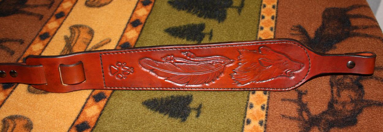

MADMAX22 Posted March 3, 2009 Author Report Posted March 3, 2009 Well had a little boute of lack of creativity or what not but finally got back around to doing some projects. So redid this one and figured that I would post up some pics of it. Quote
TomSwede Posted March 3, 2009 Report Posted March 3, 2009 Looks absolutely great!!! Tom Quote Confucius - Better a diamond with a flaw than a pebble without. --------------------------------------------- www.1eye1.se blogg.1eye1.se
