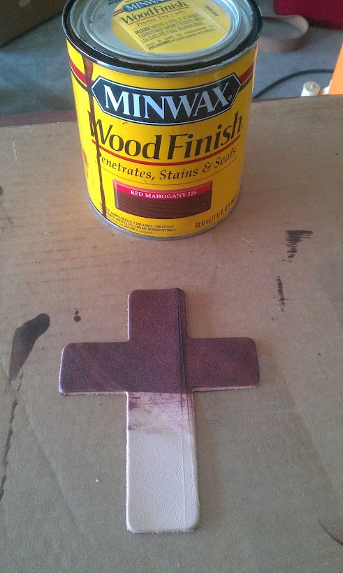

Members CountryStyle Posted July 27, 2012 Members Report Posted July 27, 2012 I tested out some Minwax red mahogany color on a piece of scrap and had great results, very rich dark color. I didnt dip it in the stain, I just brushed some on with a foam brush. I think I'll be using minwax stain quite often in the future. See attachment. Quote
