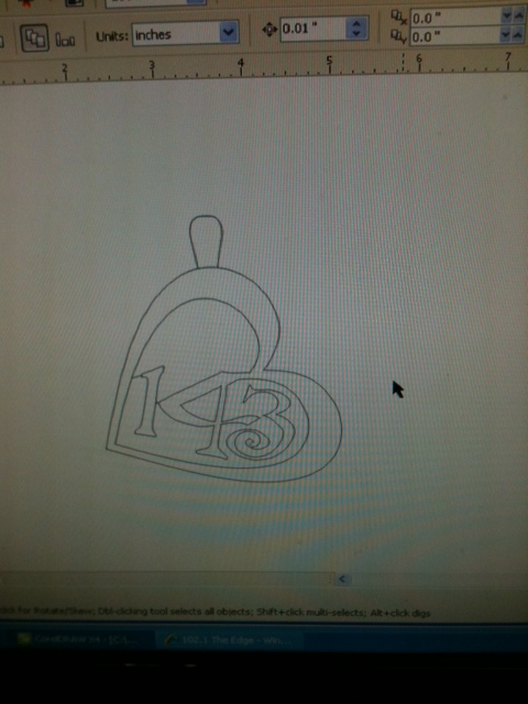

I grabbed whatever design I had up on my computer at the time, which happens to be my 143 logo.

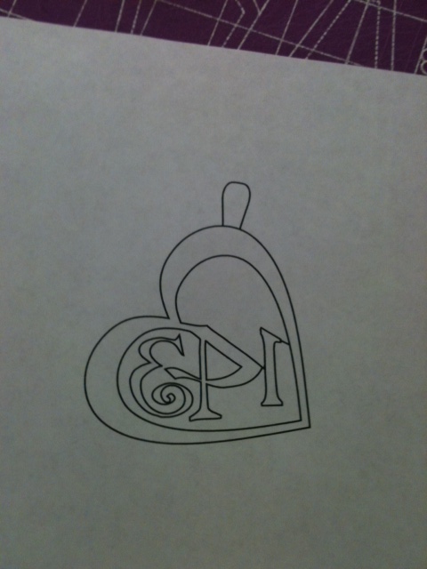

Be sure to print in mirror image because you're going to be turning it over to transfer to posterboard.
Print a pretty thick black line so it'll transfer well.

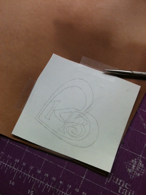

Tape face down on posterboard.
Burnish image. I use a pencil so I can see where i've been.

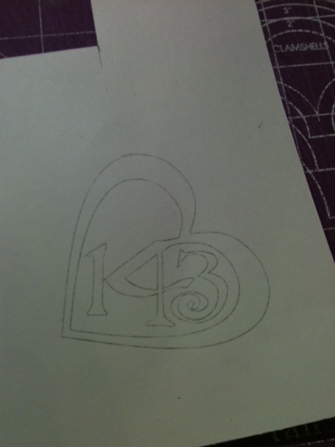

Image transfered.

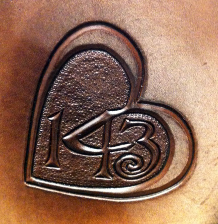

Tool and finish however you see fit.
