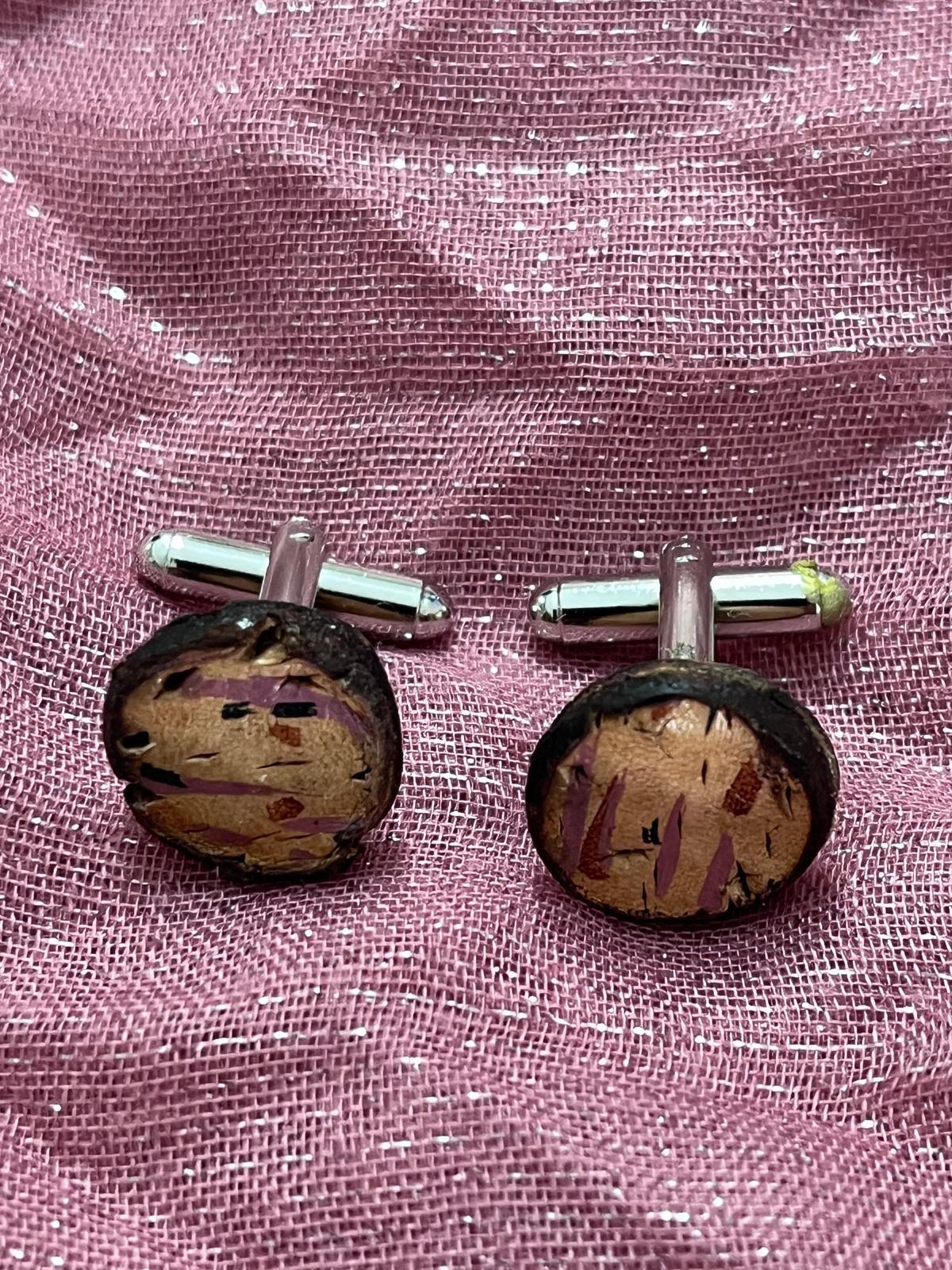

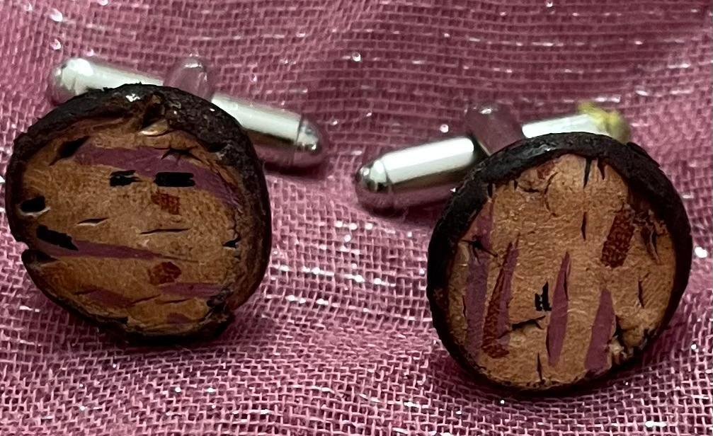

  7. In honor of Passover, I made these cuff links in the form of hand made (round) matzoh. I tooled some veg tan vachetta to create the texture, used a diamond stitching punch to simulate the perforations, then colored them with a combination of acrylic and alcohol-based markers. The edges were singed to simulate the burnt edges of the matzoh, then burnished with Tokanol. Not bad for a one-afternoon project.
