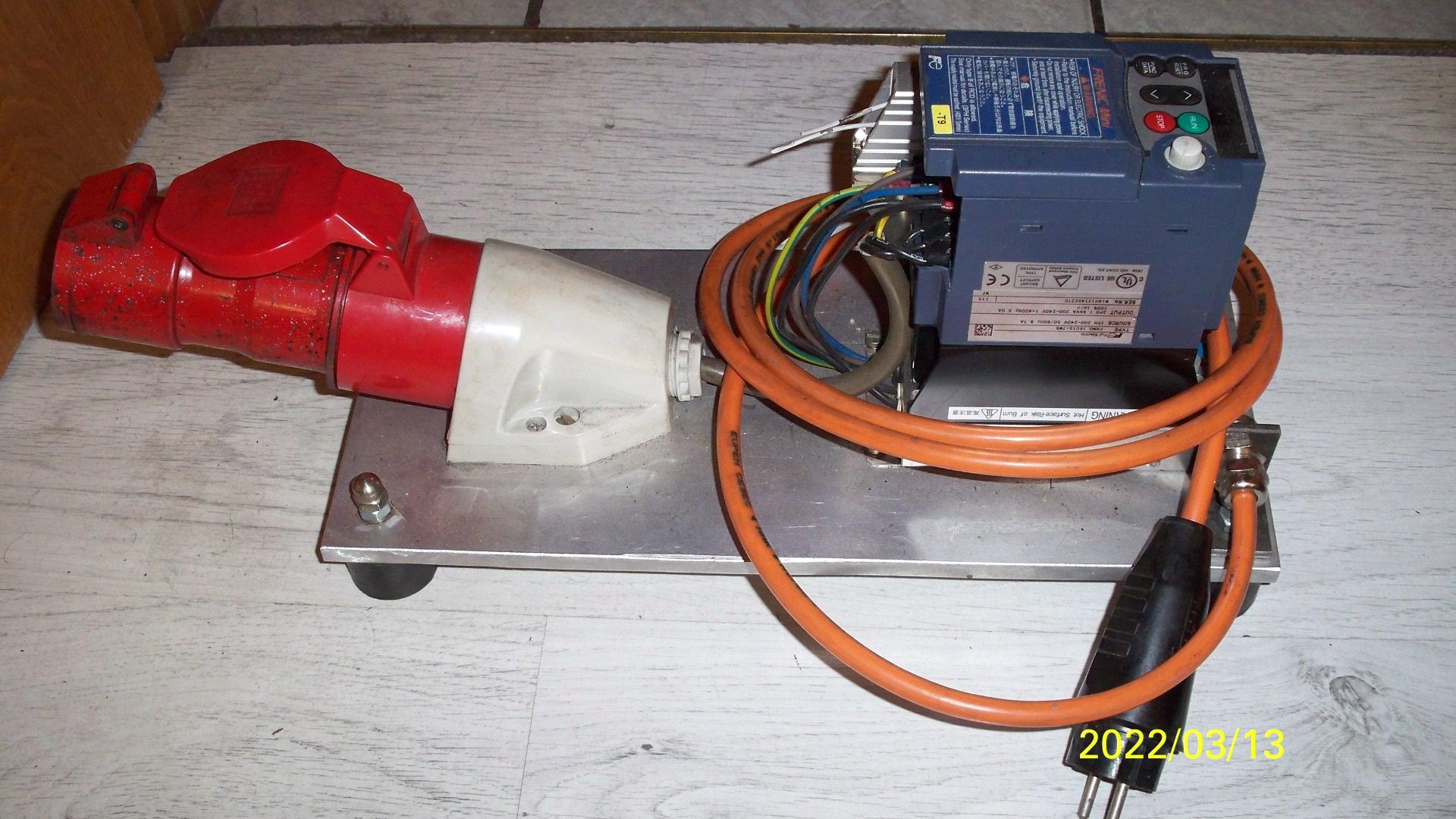

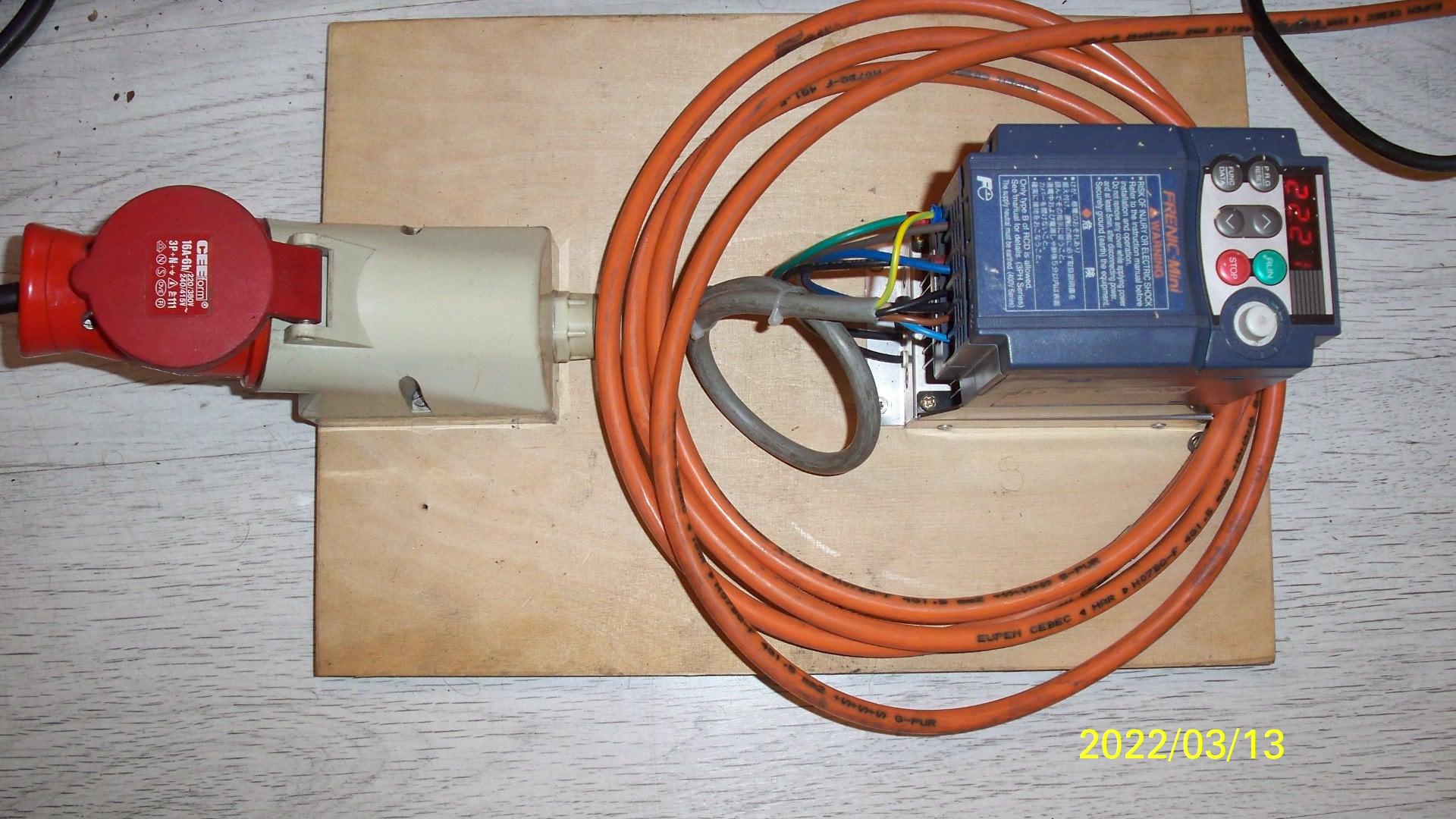

Hi, Jup - a VFD is the way to go in your case. Just remember though - in Europe most all 3-phase motors run on 380 Volts. But you can change their configuration so they run on 220 Volt 3-phase. If you want to run a VFD from 220 Volt sigle phase - you will have to also adapt to 220 Volt 3-phase which means that you have to re-arange the brass bars in your wiring different. Wiring for 380 Volts will have the bars connecting U and V and W connected to each other in line. To run 220 Volts you have to connect R to U and S to V and T to W. Only takes a 1/4 inch drive ratchet with a 7mm socket/nut. Best ya get someone to show ya how it´s done properly. VFDs from Chinesistan ya can buy via EBAY for around 80€ - best buy one that exceeds the current draw of the motor. Greetings from Germany Tigweldor

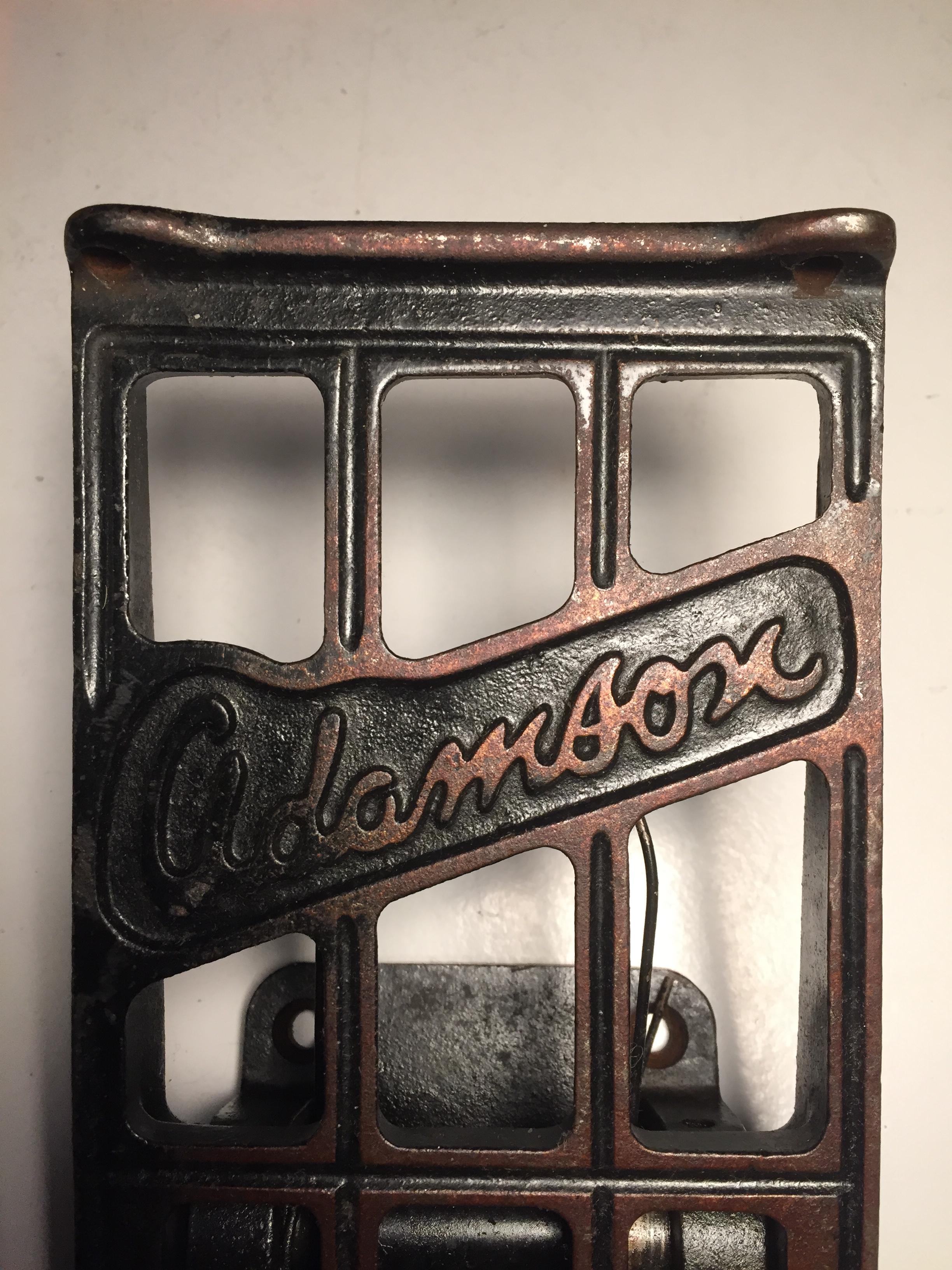

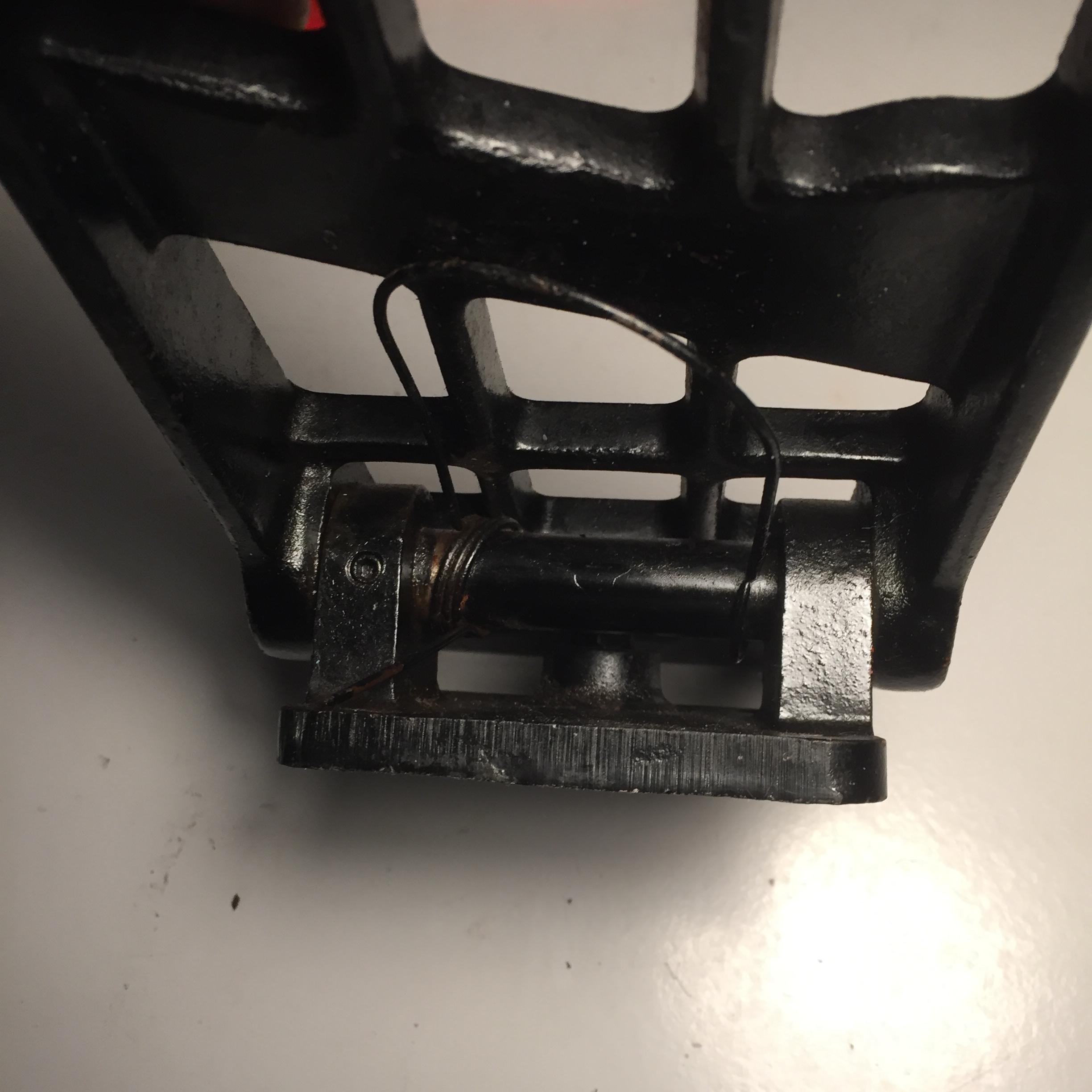

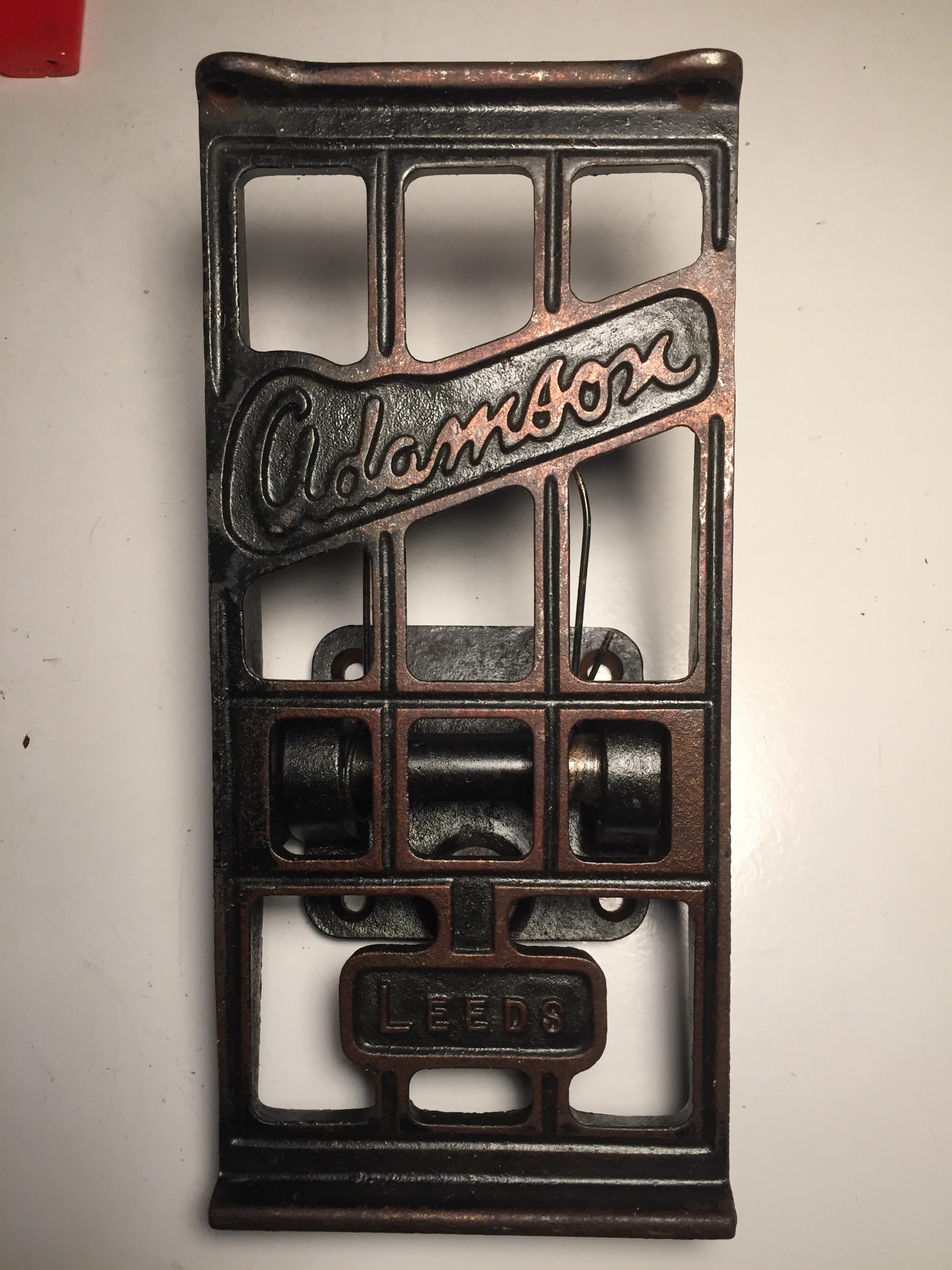

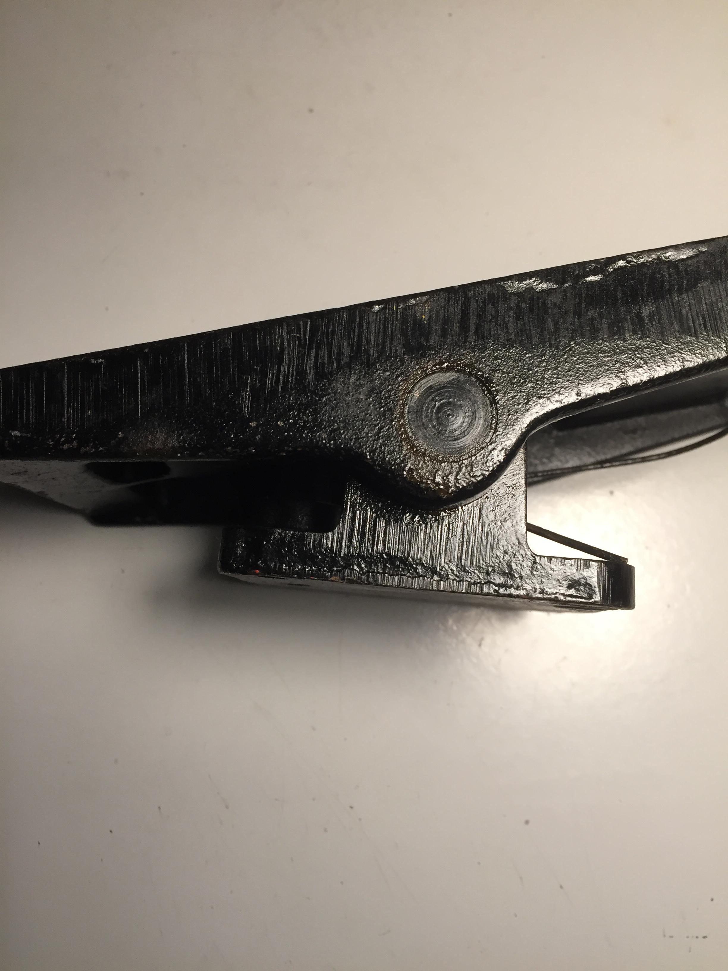

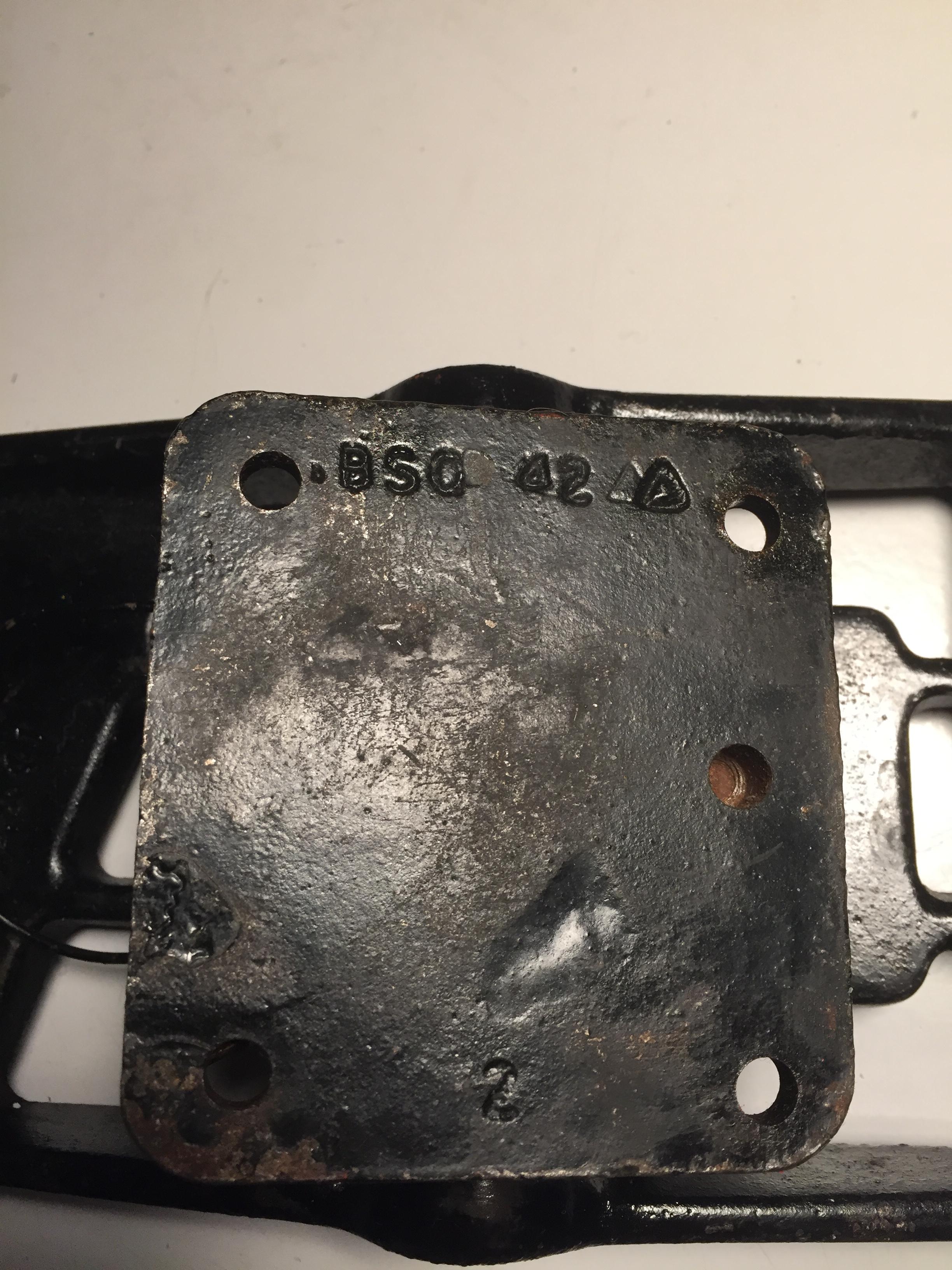

To the brits : Adamson pedal identification
Tigweldor replied to Tigweldor's topic in Leather Machinery
Well, while browsing on this here web site in articles posted long time ago (nigh on 10 years) - I found a 143 page needle chart that Con had uploaded. And guess what - the first company on the list was Adamson - and they do list the BSO models as well, so it the same company. Unfortunately I could not find any models on Ebay.UK other than the Button Sew On machines. -
