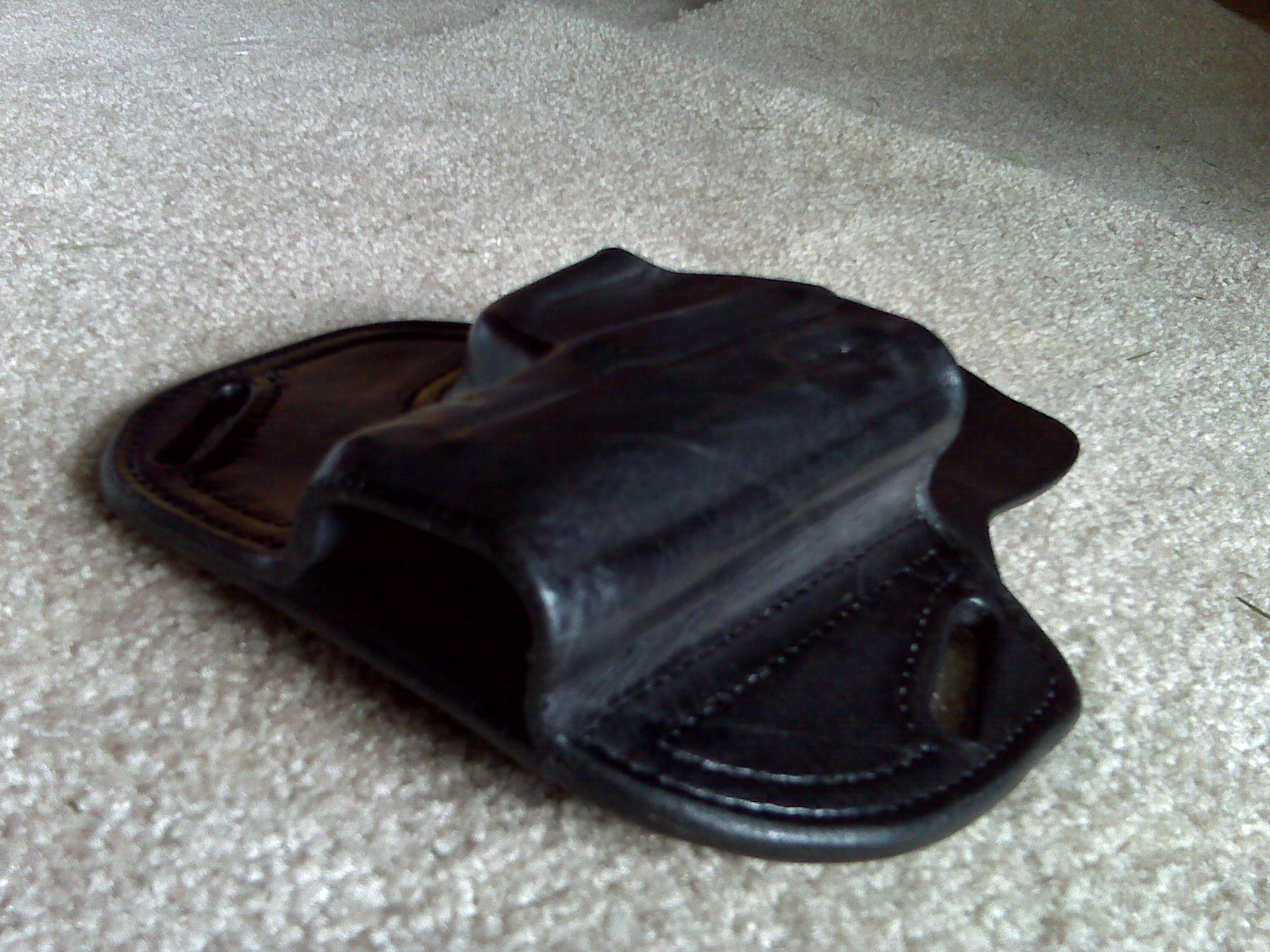

  3. Here are the results of my first attempt. Far from perfect, smells like cider vinegar and the cant is WAY too steep for anything other than a 5-o'clock position. Otherwise I'm happy. Starting on the IWB tuckable. Tried a reinforcing band using an awl for the holes instead of the drill-press. I'm either doing it wrong or it takes a lot of practice to get neat stitching this way. JR
  4. Yeah, Bronson, I'm a little hesitant to use the hairdrier with the actual holster beacuse of that. The sample did not get "hard" but did stiffen up a bit. As a control, I dipped another piece of scrap that was cut from right next to the last piece but let it air-dry. It was definately blacker than the first two, but nowhere near as black as the last. So, my guess is the heat is simply boosting the chemical reaction and the vinegaroon is not really strong enough yet. May be a usable tip for those who need to rush an item.
  5. Thanks for the compliment and advice TwinOaks. I just sampled my vinegaroon and the black looks supurb. I was impatient with this latest sampling. I followed the same procedure with the prior two, which turned out grey but could be made more black with oil: Dip for two minutes, allow to sit for about two minutes, rinse with cool tap-water. To this point, the latest test looked the same as the other two. The difference this time was I used a hairdrier on high to dry the leather instead of sitting them on the deck in the sun. The latest sample was midnight black without adding oil. I understand that heat increases chemical reactions, so this may be the case. We'll see what it looks like tomorrow. The retention seems fine at this point. A little tight and I expect it to loosen up quickly. We'll see after a couple of IDPA practices how well it holds up. Now, that I think I have a good basic understanding, time to decide what to do with the rest of the belly I got. Either an concealed rig for the same firearm, a concealed rig for the 1911, or a rig for the CZ52 - I've always wanted to see a formed holster that would accent the sexy lines of that hand cannon...

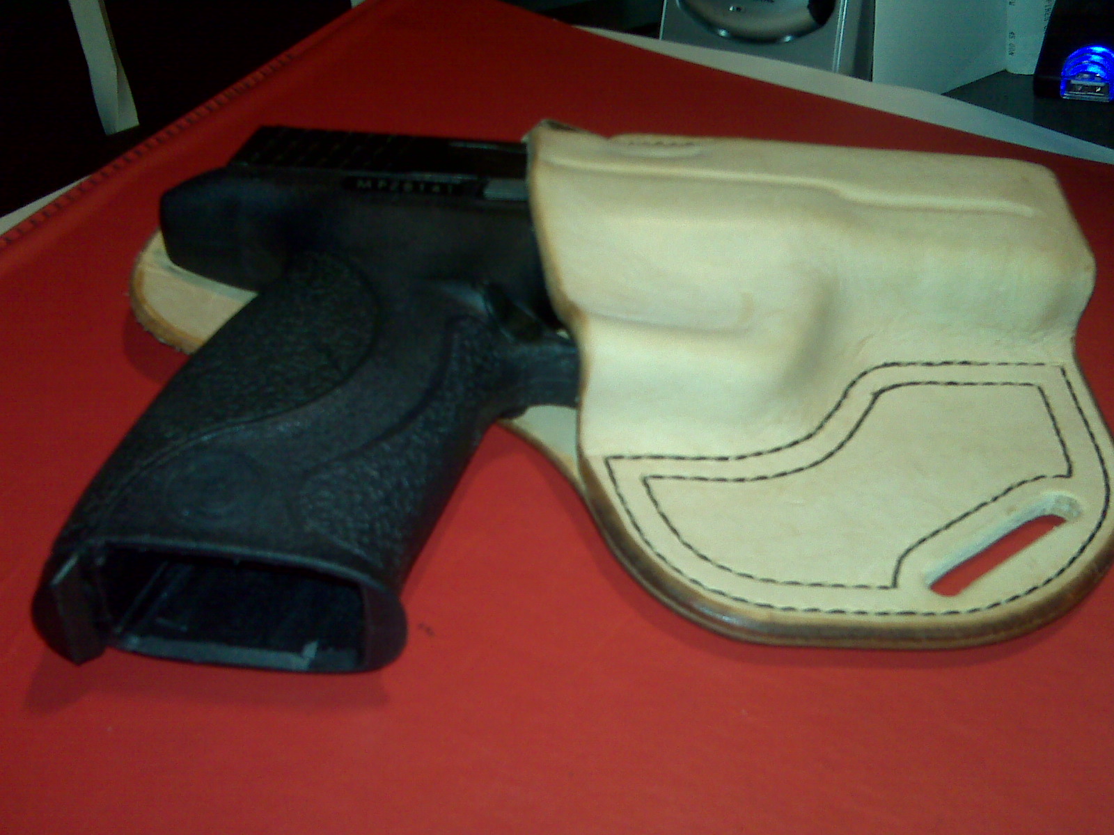

  9. Got around to taking some pics this morning. Hopefully the quality is good enough to show the items I mentioned above.
