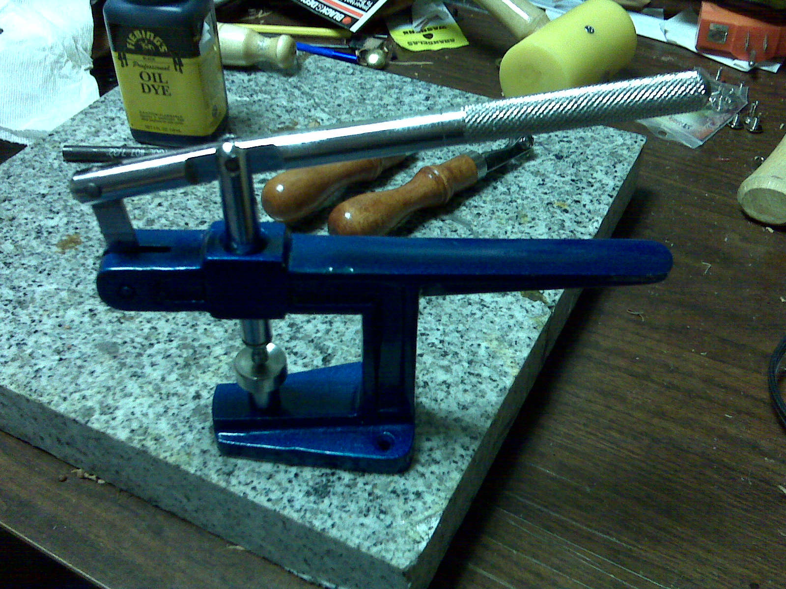

Here is a press-style snap setter I made from a $13 Harbor Freight Watch Case Press. Total time invested was about 1 hour. Drilled out the upper ram to 1/4" to accommodate a standard snap setter rod (cut to length) and drilled a blind hole into the anvil with a #7 drill bit to hold it on the base. Had to put a different handle on it (not shown) as the original was not strong enough to handle the force needed to set a snap really firmly. Simply used some 1"x1/8" aluminum bar stock I had laying around.
