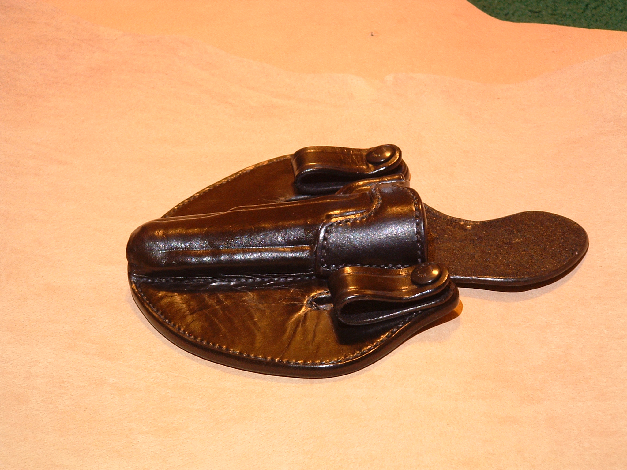

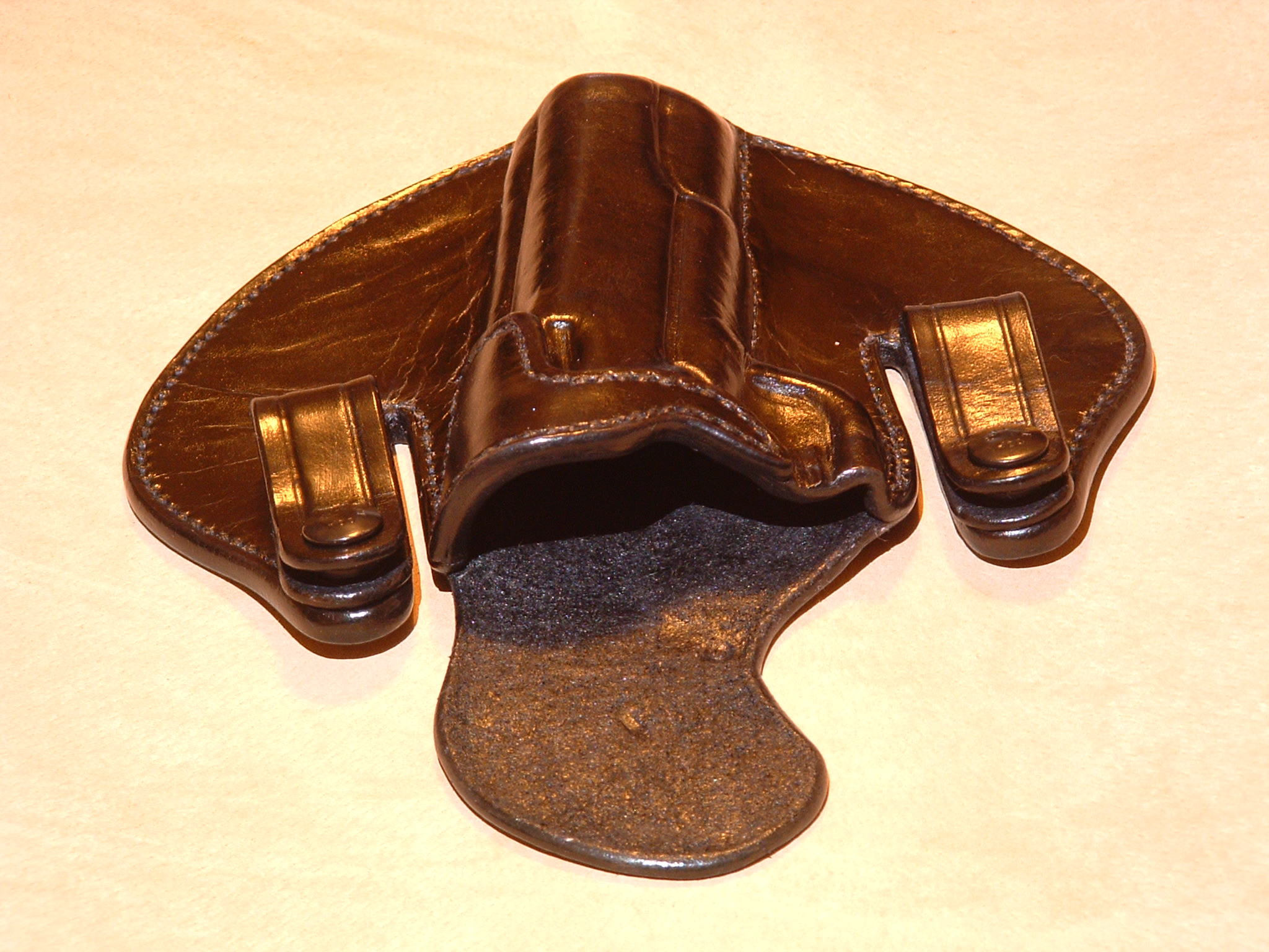

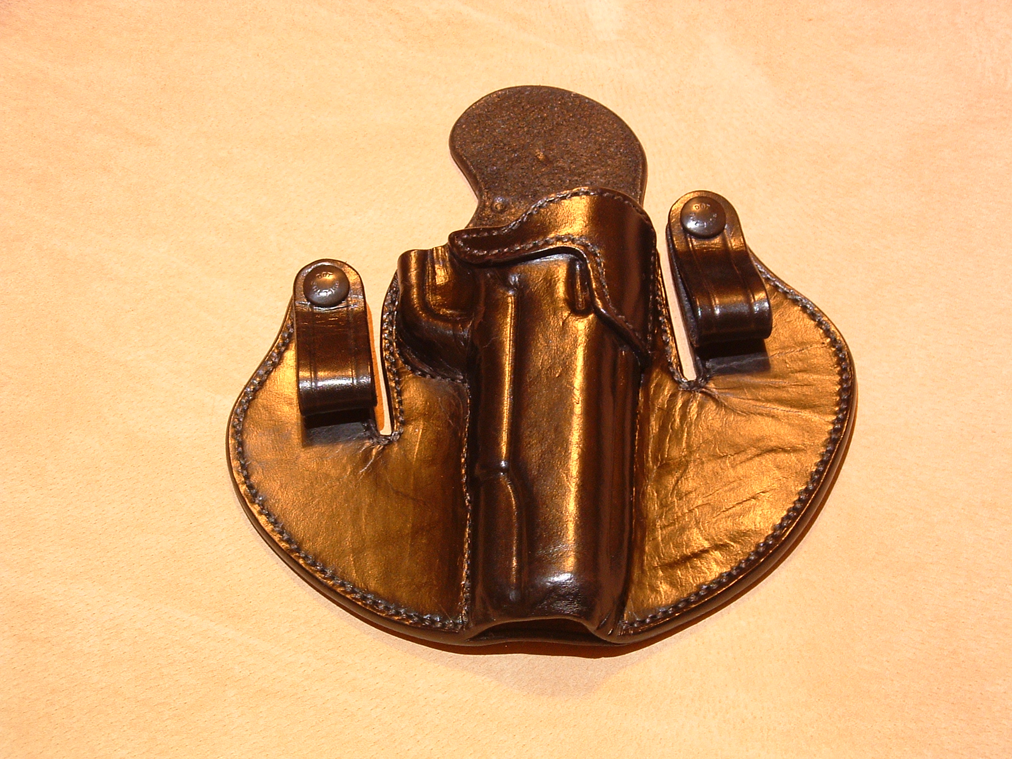

I had promissed two guys I shoot with that I would make them 1911 holsters similar to the holster I had made for myself. Since the pattern was proven I made an aluminum pattern out of the paper originals and used it to cut out the first pieces with it. After cutting the pieces out, I realized I had forgotten to mark which-side-up on the templates - the original design is a flesh side out... So, it either became a smooth holster or a lefty and neither of the shooters is a lefty so I went with a smooth side out and would ask if either was interested after it was complete. The first guy I showed it to said 'YES' without pause... Still working on that final fit-and-finish to match the quality I'm seeing from the others, but at least I have my edges down.
My second holster to go to somone other than myself. I'm really happy with the results. Especially after comparing it to the original proof-of-concept. Still need to work on a few things with regards to fit-and-finish, but as I said, I'm really happy with the results. Comments/critiques/criticisms welcome.
