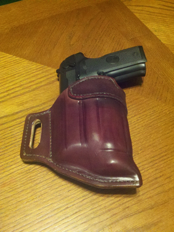

Design heading out the door tonight. Handgun is a Beretta PX4 Storm with a Vector Optics Sparkler red laser attached. Didn't like the protruding mounting screw so I decided to add a molded Kydex sleeve to keep the channel from collapsing and keep the screw head off the leather. If I had to do it again, I'd add about 1/2" to the length of the belt slot tail since the boxy configuration does not allow the belt to pull in like in a normal Avenger design. It's still very comfortable to wear even with this shortcoming. As always critiques are welcome. Here you can see the Kydex insert from the top end of the holster. The stitches are placed so they fall into the void between the handgun frame and the laser body so they should not wear. The stitches to right are not really pretty (forgot to hold the Kydex against the holster when drilling - it was late) but serve their purpose. This is the Kydex sleeve as seen from the muzzle end. When holstered, the sleeve just blends in...
