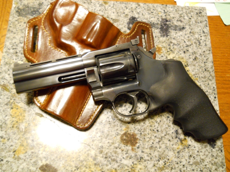

Sure can. This barrel was made by CZ (who now owns Dan Wesson) but follows the standard style of the Dan Wesson heavy barrels. It looks identical to the original 6" which was made in the Monsoon plant. There is another company making heavy barrels which look awful (My opinion) - They are essentially just big rectangles. -

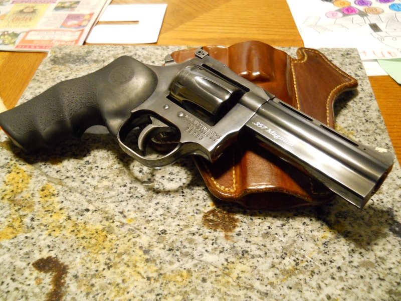

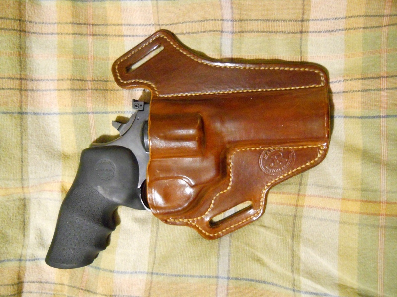

I would say it is all in the design. This is my pancake for my DW Model 15 with a 4" heavy barrel (It's mine so the fit-and-finish are not the best and it was the 4th holster I ever made and the first with horsehide so bear with me). I would, however, speculate these are not the ideal revolvers for IWB or even concealed carry. They are rather large. -
