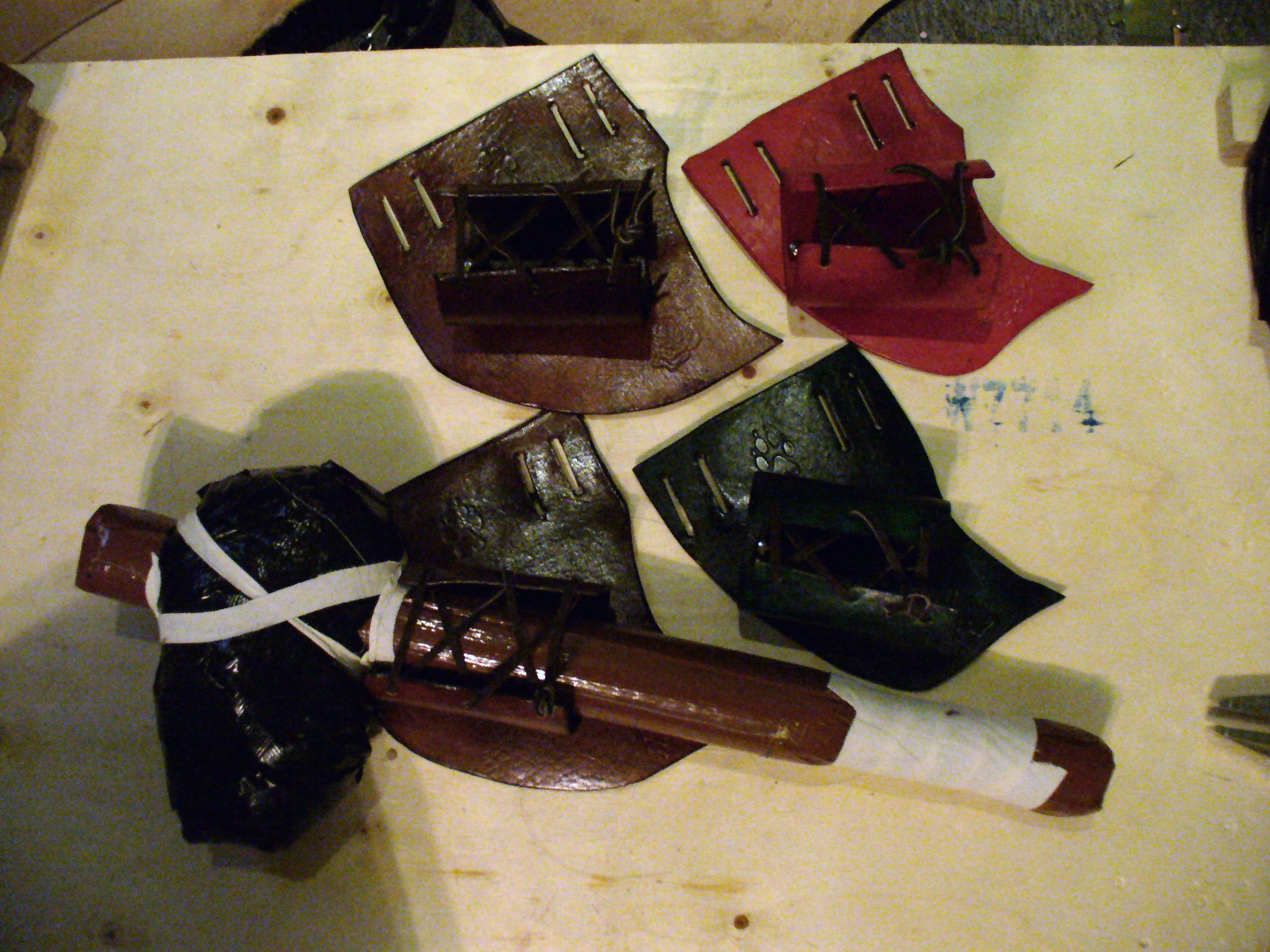

	I've been working on a conceptual armor for a while, it is not yet perfect. It is armor grade (15 oz) the tunic is ''caribou'' (sorry I am not sure of the english word...)
