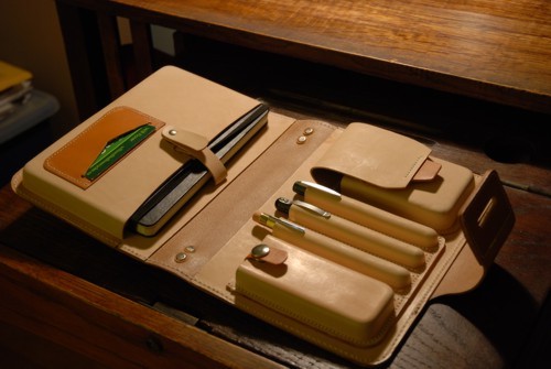

  1. Hello everyone, I have been experimenting with molding over the past year, I'm quite happy with the results I'm achieving now (check out my molded pen/notebook case I made recently). A few days ago I came across this company Il Bussetto who is making these seamless molded cases (see the attached picture). This looks unbelievable, can you actually make the leather streach this much? Has anyone here done something like this? If so do you have any pictures of your mold forms? I would love to try this out. Cheers, Will

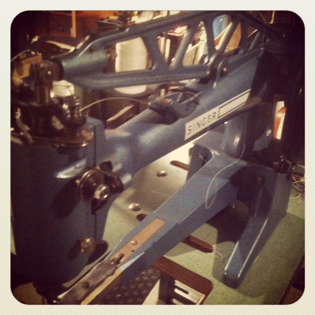

  2. This model is the 29U 172A. Essentially the same as the K models with a few minor changes. As I understand it they made a 29U 171, 172, 173 in Japan. I would guess this is the last batch of Patchers Singer made. I love how mint the condition of this new one is, however it lacks a bit of the character of the Scottish made K models (decals and badges).
