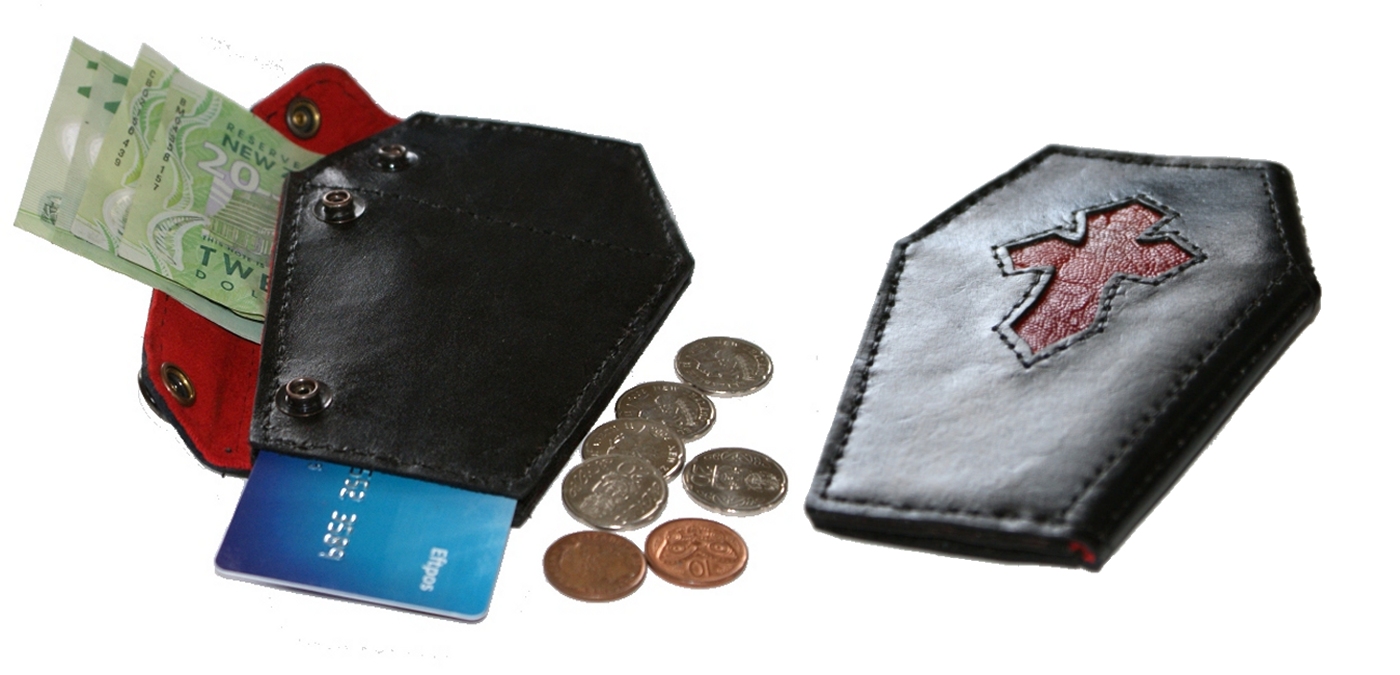

Been doing a couple of new ideas thats been in the back of my mind for a while, coffin coin purses, so the other weekend I put I couple together. The first one is just a simple coin purse in the shape of a coffin, just the one compartment. That turned out ok so thought I would go a little flasher and try out some other things and use some of my other bit of leather I've got. The second one is a little bit bigger and you can slip a card or two up the end of it, it has a cross cut into it with red ostrich leg leather inlaid into it, then the inside of the purse is lined with red lamb skin leather. They both turned out well I thought so am thinking of going bigger and making a one with a couple of compartments for money, a better card slot etc, then I might move onto a shoulder bag or something.
