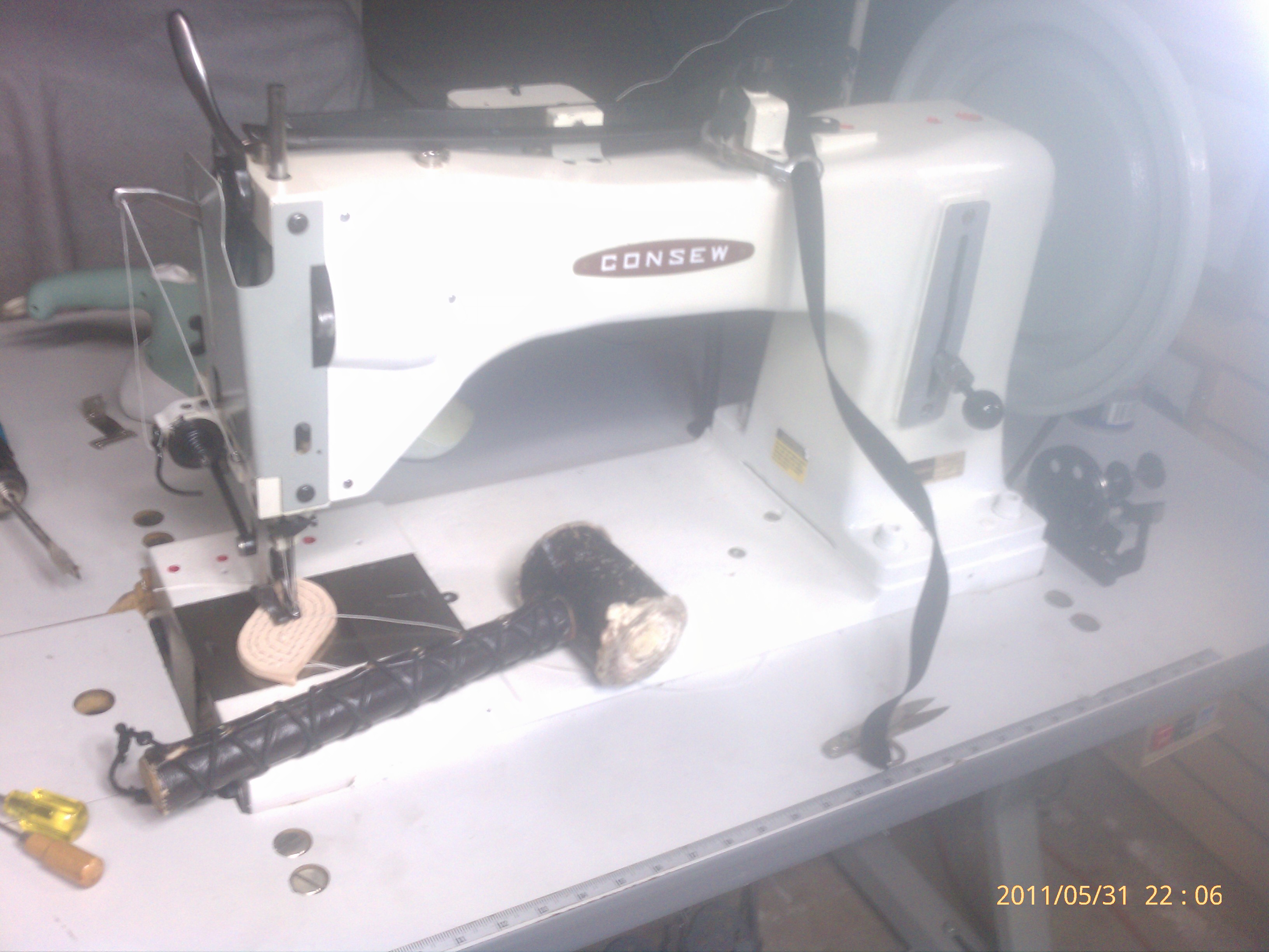

  1. In bound rig. (The Mallet is only there for scale)

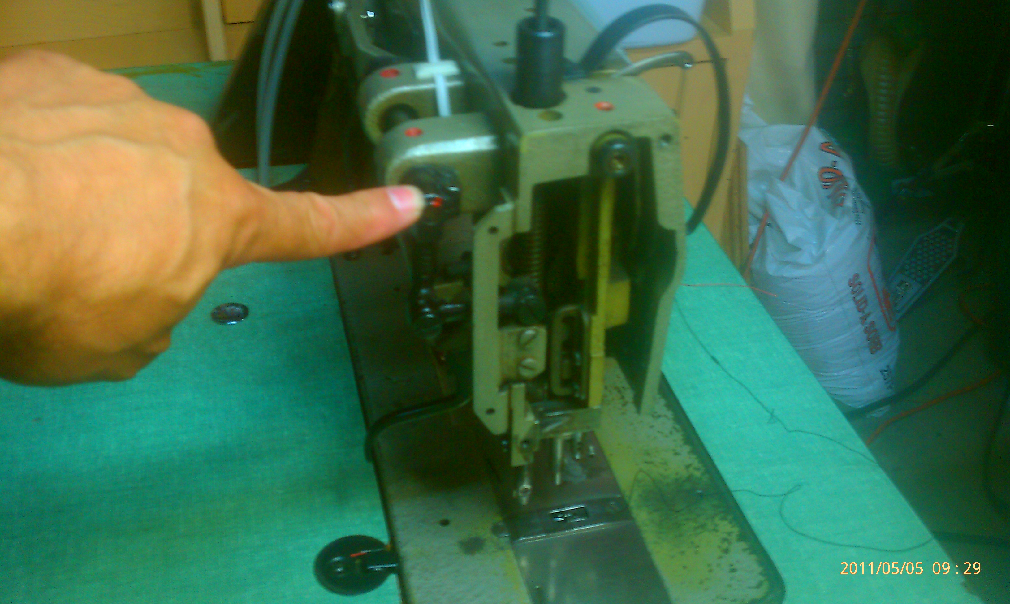

  7. This photo is my Pfaff 1245 with the side cover off. My finger is pointing to the gross adjustment. There are two slotted screws facing the top. I would STRONGLY recommend proceeding with care!!! I would: First take a paint pen and put a drop of paint on the side of the shaft and the bracket so you can go back to where you started. I used red as you may see in my low grade cell phone photo. (please excuse) Second make sure you use the proper screw driver. (go buy a brand new one if you have to) the screws will cost more than the driver will it's up to you. Third Loosen the screws ( don't remove them) just enough to move the clamp on the shaft. A small move between the clamp and the shaft should show huge move between the feet and the table. Fourth tighten the screws. your done Good luck, Al
