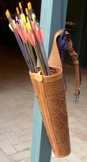

  12. From the album: Barrie Bailey's Leatherwork - 2
    This is a back quiver carved and tooled and lined with pigskin. You can see the method I use for separating arrows.

  17. This is my latest Back Quiver. Image 1 shows the carving and tooling (basket weave X510). You can also see the arrow separation and the adjustable harness. Image 2 is a close-up of the harness assembly. The harness can be changed to left or right. Image 3 is another view of the acorn carving and the joining method. Image 4 is a close-up of the joining method. The edges are laced with the double cordovan braid then another length of lace is used to join the two together by stitching through the top loop of the edge braid. I will be putting together a Tutorial on my website as soon as I can. As usual, I would appreciate any comment. regards, TapTapTap
