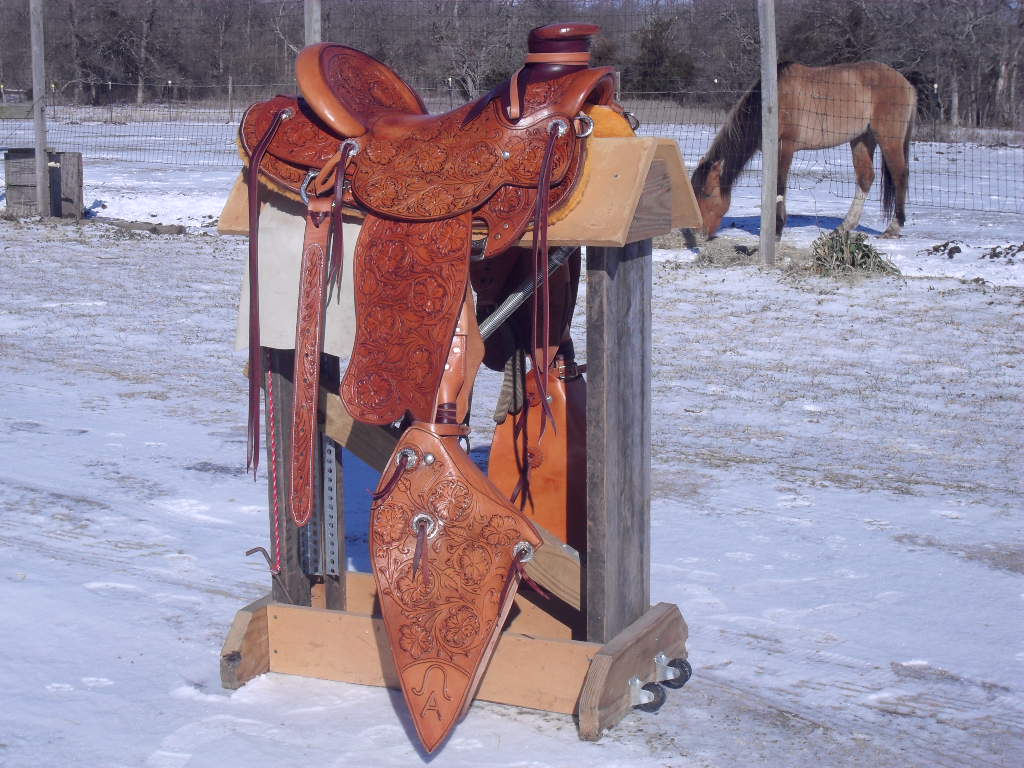

Here are some pics of a saddle I made for myself, I'll try and get some close ups later but wanted to post it here. It is on a Nikkel tree, Hermann Oak leather fully tooled, 22" tapaderos, latigo wrapped 3X4 horn, 4" cantle, crossover rope strap, wrapped and set stirrups. Any comments, critiques etc. welcome and appreciated! Vaya con Dios, Alan
