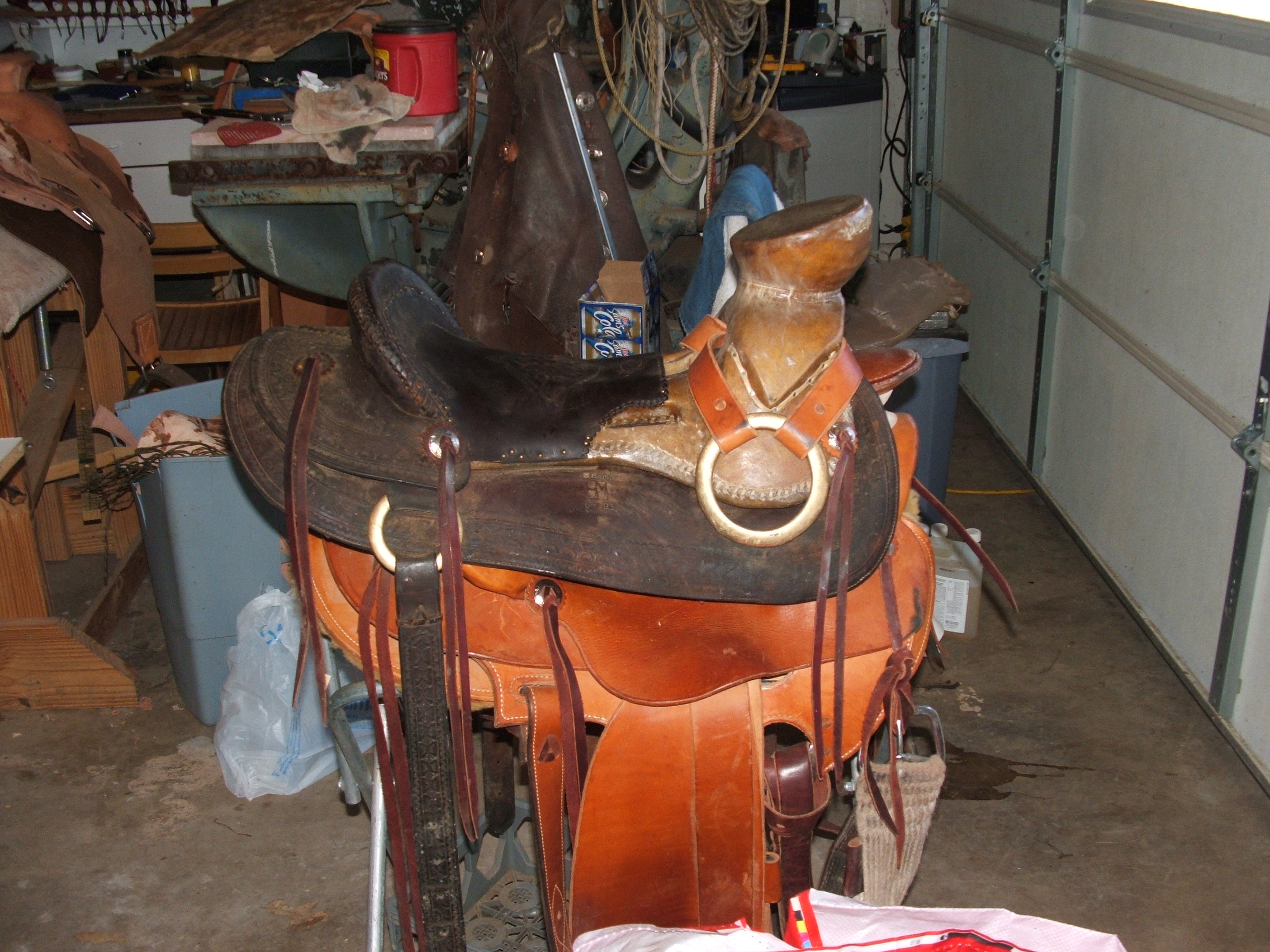

				Bob Marr saddle repair
Alan Bell replied to Alan Bell's topic in Saddle Identification, Restoration & Repair
Thanks Knut, that is a good idea! Vaya con Dios, Alan -
	Had a friend ask me to repair this Bob Marr saddle. I don't know who set it up like this but shouldn't the front rigging ring hang below the tree? Is there a better way to hang that ring other than the two straps? I got to build new stirrup leathers too as the one he had on the saddle were made uneven! Vaya con Dios, Alan
