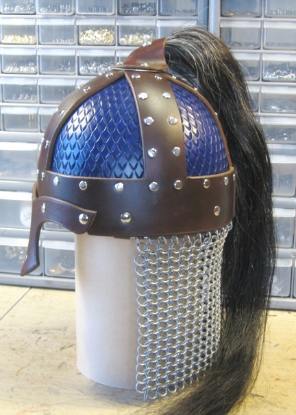

Thanks Mark. Here's a pic of the inside. Also, the blue dye is a process I've worked out over time, using just Fiebings dye. First I use Leather Balm on the cuir buoillied (hot water hardened) leather to restore the leather. I wait a couple hours then apply some Atom Wax, which is a water base wax. When that's dry I apply the dye, and the atom wax sorta liquifies and mixes with the dye, but it also keeps it from penetrating the leather and getting dark. So, when that dries I have the dye/wax sitting on top of the leather mostly. It could be sanded off if you really tried. Then I seal it all with maybe 3 coats of Resolene mixed 50/50 with water. So, that gives me a durable, bright color. The drawback is that it can fade in the sun faster than a regular style dye job because it hasn't got much depth. I sometimes dilute the dye with alcohol, so I can really lay it on heavy, trying to get more penetration when it mixes with the Atom Wax.
Thanks, King's X. It's no Archangel helmet, for sure. But I make them to sell between $150 and $300, depending on how many features a customer selects.
Thanks Dimitri. I would have never made this if I had to cut my own plates. I drew out a lot of easier designs, with large plates, before I settled on this. I was bitten by the authenticity bug, so had to use the smaller lamelleae. Also, I've gotten to be much more patient as the years go by.
Here's a picture of my most recent helmet. The customer wanted the blue, and I'm really pleased with how it came out. My customers are often responsible for making me forge into new territory. Doug

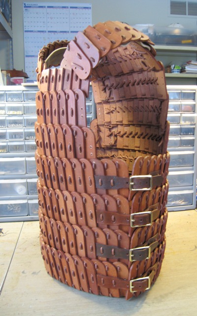

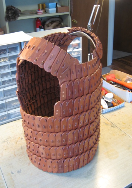

Here are some pics of my latest project. It represents what a Varangian Guardsman would have worn circa 1000. The Varangians were Viking mercenaries who were the personal bodyguard of the Emperor of Constantinople, in the Byzantine empire. They would have drawn this kind of armor from the Byzantine armory, besides wearing their own personal gear. I didn't make the plates. I'm not crazy. They were made by a fellow named Torvaldr who has a clicker. There are about 275 plates in the vest, and it took me about 12 hours to lace it all together. The plates were purchased already hardened by heating them, then melting wax into the leather. Doug

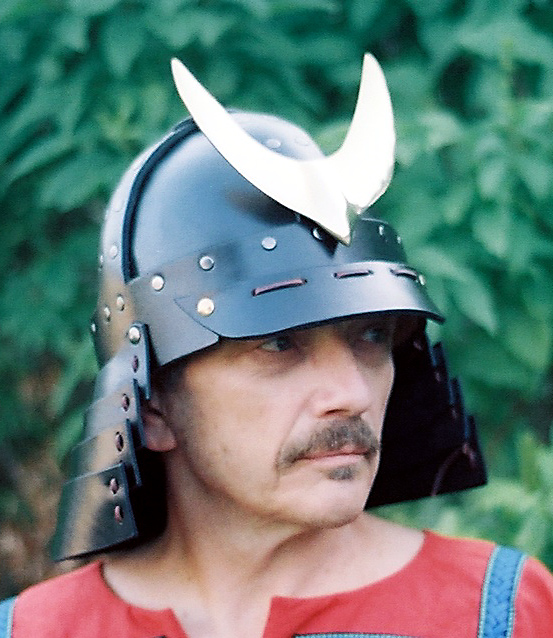

Here's a picture of my attempt at a Samurai helmet. Not really very accurate, but it captures the overall appearance.
