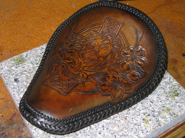

  7. ok friends ...now is the time to realize and show my saddle... rebuilded from the scratch....the border all around is 8,5 mm thick, it is hand-painted and hand-sewed...obviously let me know your opinion....
  8. Thanks....and now a reply: the seat is wet-hand formed + glue.... and variations of color is done using alcohol base dye diluted and different size of brushes....

  11. Just before dye black all the background....

  13. It's very thin, I'm not expert in your system you use weigth ...we use milimetres it is 1,2 - 1,4 mm
  14. nautical foam inside, veg leather for the top and calf all around
  15. Thanks to you all, specially to David that is the artisan that realized the saddles that originated my question.... I was thinking in a double way, brown dye and black airbrush, but one thing is to be sure and another is think about ..... thanks again to every one of you....
