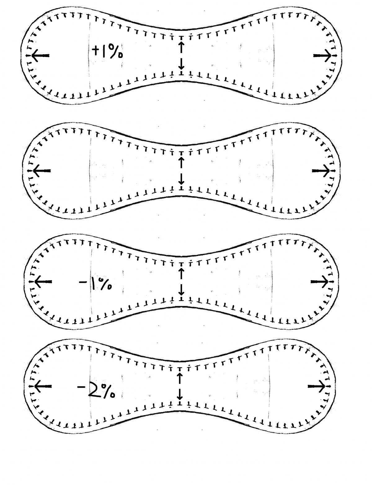

  2. No prob! For best results use a round core. And its usually better to size the pattern a bit smaller than larger. At least if its tight the leather can stretch. If theres too much material it tends to bunch up in areas which spoils the round shape.
  3. Hey just wanted to say thanks for the pattern. It didn't end up perfectly round and I realised it was because the pattern wasn't very symetrical. So I tweaked it with photoshop to make it symmetrical for rounder results.Below is what I ended up with, using spongy stress balls as the core. Wouldn't have done it without the original pattern though. Thanks! Thought id share my pattern in case anyone needs it. Its sized for a stress ball, about the size of a real basball, can't remember the exact measurements though. You may have to tweak the size to fit your core.
  4. Yeah I considered leaving some allowance. But I can't figure out how much allowance to give. Due to the shape trimming cleanly after wet forming is going to be difficult. Of course I can do some trial and error but because this is more of a one off project I don't really want to waste too much leather on it.
