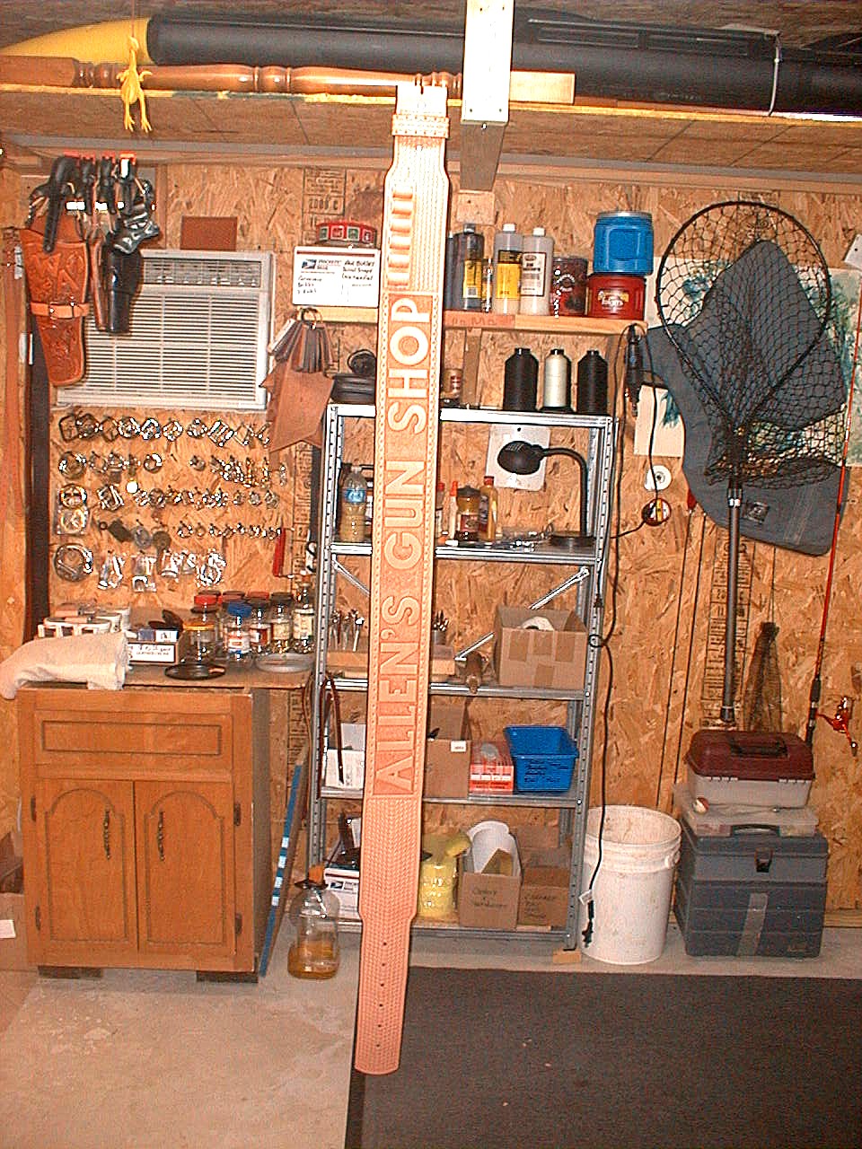

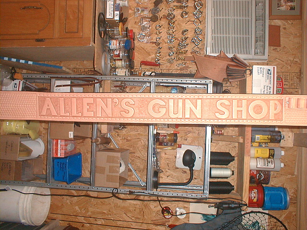

	  Finished Big Rig For DealerGeorge B posted a topic in Gun Holsters, Rifle Slings and Knife Sheathes Hey All, finifhed the giant rig ordered by a local gunshop. Used antique dye for the first time and kinda like the effect. Measures 84.5" long, 5" wide with the only 4" buckle I could find. Can't figure out how the holster came out redder than the belt. Same side, same oiling, antiquing, etc. took the belt out of the back and the holster out of the belly, maybe that was it. Left handed rig that holds 6 .50 cal. or 12 ga. shotgun shells.
	  Giant Rig For Gun Store DisplayGeorge B replied to George B's topic in Gun Holsters, Rifle Slings and Knife Sheathes Hey all, buckle is correct, left hand so the holster is not in front of other displays. I also would have liked to have placed loops farther into the middle, but I wanted the name to have the top priority. Thanks on the basket stamping. Not as bad as stamping an entire saddle skirt, but had to stand up to stamp due to the length of belt. Buckle should be here today or tomorrow and then I can finish it up. Holster pic was too large to load so I will put one on of it completed. Thanks!

	Completing a gun belt for a local gun dealership. Belt is 5 inches wide and 85 inches long. Used Siegel 14-15 oz. California double tan skirting leather. .50 cal. loops, awaiting the 4 inch wide buckle Had to hand draw all the letters. Background is a lining tool Full dealer name, belt will be supported by a 1 inch by 4 inch plywood backing Holster is oversized with partners initials. Cannot load pic, will load all when completed Will antique, oil then tan-kote and mount.
