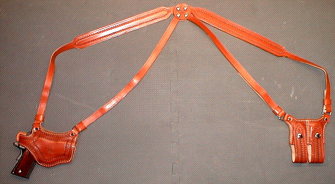

Shoulder Holster: How To Do?
George B replied to GianniWest's topic in Gun Holsters, Rifle Slings and Knife Sheathes
I tried a few different patterns when asked to do the first one, drove me crazy. I finally started using a simple Jack Ass style rig and have found it to be the most comfortable. Look at El Paso Saddlery for an example. Here is the first one I completed for a customer. I shortened the straps when I did the final fitting. -
