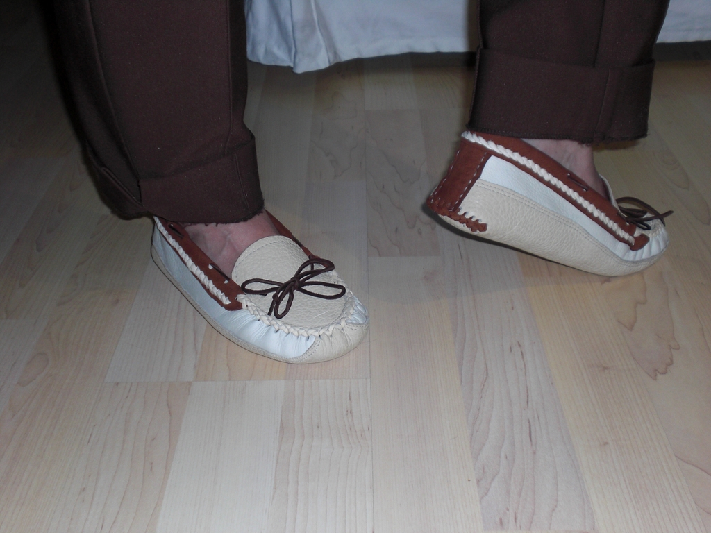

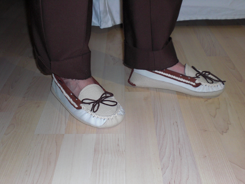

  11. Hi folks, Just finished this pair. Has triple sole (with felt midsole), made from the 4 oz buffalo/heavy 7 oz white deerskin and nubuck thin 1.5 oz deerskin as lining. Laced all around with 2 different styles. Current owner with his new pair shoes is on the second pic
