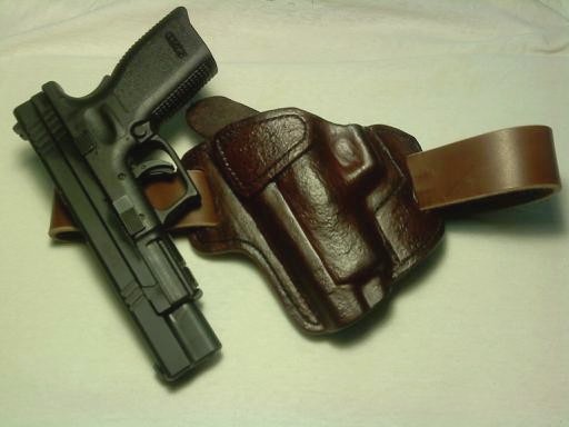

P.S. revolvers using a pancake style need a little extra rooom to accommodate trigger guard because of the cylinder width - when ya squeeze them in, the opening can all of a sudden squeez down and become too small I made a pancake for a .357 and left about 1/2 " all around using 7-8 oz and it was a tight fit but it streced in and worked well. The folowing S&W .500 using 9-10 oz was not so agreeable . The almost 2"width of the cylinder/frame and less strech made my estimated 1/2"-3/4" over size on the outlline too close. I ended up making another and adding +3/4" to the trigger guard side - next time maybe a thick welt all around for heavy leather and a big gun ... live and learn...

-hello all thanks for any advise offered it is asways helpful --lately I started makeing holsters and have really enjoyed it . Usually I can get the gun so I lay it out and draw a pattern. Do whatever for texture or carving and then sew it up etc. So far it has been OK until I got into a couple revolvers. the Question : Is there a rule of thumb to use to accommodate the varrying cylinder bulge when putting a pattern together? I usually use 8-9oz back and front and I am parcticiing on OWB pancake style. last one was a .357 & I used 7oz on front so i think i gotr some forgiving strech and it streched enough to work. recently I tried to use the same method for a S&W .500 -- laying it down and tracing around the gun, then added 1/4" to the overall tracing outline, then draw the pattern for loops and blending it all togrether--- BUT... using 9-10oz --- when that gun met the leather ----NO WAY!!! totally POOched it. the gun was almost 2" thick i i know now I did not accommodate that --- so I'm looking for advise on how to correct or accommodate that third dimention in a specific area of the holster when workng with revolvers Anyway thanks for any advise DN
