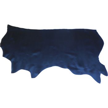

I'm planning to make a fold over wallet with calf leather thats aniline tanned (1.2-1.4mm) . Can this type of leather hold its shape the same way oil tan holds its shape (not as stiff as vegtan but able to still retain shape). The leather on the website doesnt have pics of the product draped like some thin chrome tans seem to because it seems to be a bit stiff. It will be lined with another leather thats a bit stiffer to retain shape if its too soft or in-between the pieces some type of mesh or lexon.
http://leather-online.it/en/home/50-aniline-leather-black-calf-skin-for-leather-goods-bags-wallets-shoes-binding.html The leather seems like a steal at that price 12 square feet at $8/sq foot. Maybe 9-10 usable square feet still at 9-10 dollars. Other italian and french leathers are 18 - 25 a square foot for the leather hermes uses. Is this leather a cheap imitation of that sort of high end hermes type leather or a good priced premium calf leather in the quality range of what horweens puts out. This leather will be used for wallets both unlined and lined with thin leather. I will pay for the samples if they seem to have leathers that are high quality.
