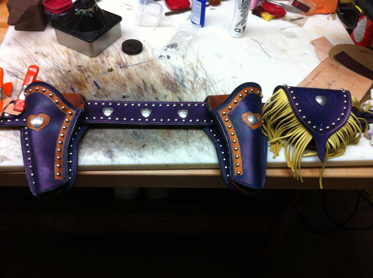

Mike, Thankyou for that in depth reply. All good advice. When I re-dyed the holsters I really shook up the bottle of blue dye first thinking exactly like you said. When they dried there was no dye particles coming off on the buffing towel... guess that was the problem. I'll also probably add some alcohol too. Good call. -

Phil... Good post...great sense of humor.. Some others have chimed in and just said I need to really buff out the pieces with some cloth or other...towel, piece of denim..what ever. Never had this problem before but...the dye is old, the leather is old too but still seems/looks new. I dunno but will likely write to Feibing to see what they can offer. Just FYI, I'm still ordering things I need and used to have but can't find I always have a list. Some of my friends and fellow shooters like my work but no one wants to pay for it...grrrrr -

I just finished a set of holsters and belt in Feibing Pro Oil in Royal blue. They look cool but the blue rubs off on your hands and when I went to wet form the holsters the water turned blue. I had to re-dye them when they dried. Never had that problem with any other color of Feibing. Sure like to know why it did that. -

Ha....that's an image that's hard to imagine The color is Feibing Pro Oil dye in Royal Blue but it's not great quality dye...at least this bottle isn't. When I went to wet form the holsters to her set of Rugers the dye came off in the water...not all, of course, but so much I had to redye them when dry. Never had that problem with any other Feibing dye. My wife tried it all on last nite and the dye rubbed off on her hands too. I'll buff them heavily and see if that helps. Any other suggestions are surely welcome...lotta work to have this kind thing happen. Mark -
