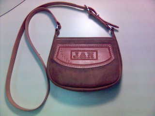

Hello Everyone, I'm gearing up to start out in a new direction. Most all my work in the past has been related to either horse gear or rendezvous gear. I've been doing that for more than 15 years so I pretty much have my suppliers that I like. Now though, I want to start making purses and handbags. I've been struggling for a couple of weeks trying to find really good quality hardware and it seems that everyone pretty much has the same stuff. I'm experienced with Tandy's hardware and a lot of it isn't very good, to me, and it seems that all the other suppliers pretty much carry the same kind of stuff. I have finally signed up with Ohio Travel Bag and I'm making up an order. I'm just afraid I'm not going to like the quality. I'm trying to order a pretty good inventory so I'll have what I need once I start working. Anyone have any suggestions that could help me out before I order? Keith
