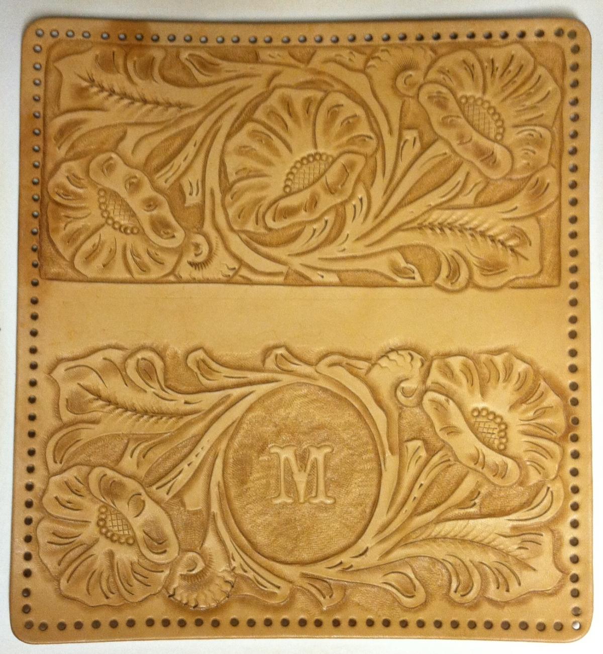

DoubleC, thanks for your response. I may be changing my mind and just leaving the whole thing natural...it's a Christmas gift and someone who knows the person well thinks they would just like the "natural beauty." On a test piece, I rubbed in some Resolene and a patch with Tan Kote. I like the way the Tan Kote darkened the burnished areas just a touch...in your experience is Tan Kote good enough to use as a final top coat, or should I Tan Kote then put something else on? Thanks again for your advice!
Hi all, I'm looking for advice on what types of finishes you apply to leather to leave it "natural" from the tooling/carving. I'm wanting to finish the checkbook cover in the picture....what I'm thinking is using Fiebing's Chocolate Brown to die the background sections, but I'd like to leave the rest "au natural." What would I use to finish that off? Thanks for any advice, and happy holidays to you all. PS Thanks for all of you experienced folks who have been so generous with your help and advice. Its been a year since I started this addiction <er> craft, and would have given up on it if not for the help and advice of you fine folks. PPS If there's any critique of the work as well, let me know. I know in particular my pear shading and decorative cuts still need work... PPPS (Last one, promise) Ignore the splotchiness of the corners...I took this with my phone 10 seconds after I finished, so the leather is still drying.

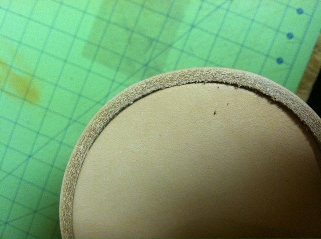

Electrathon & Lou, Thanks for the suggestions...I picked up a bar of saddle soap from a tack shop. Would you recommend slicking the edges before or after I paint them with Super Sheen as a resist?

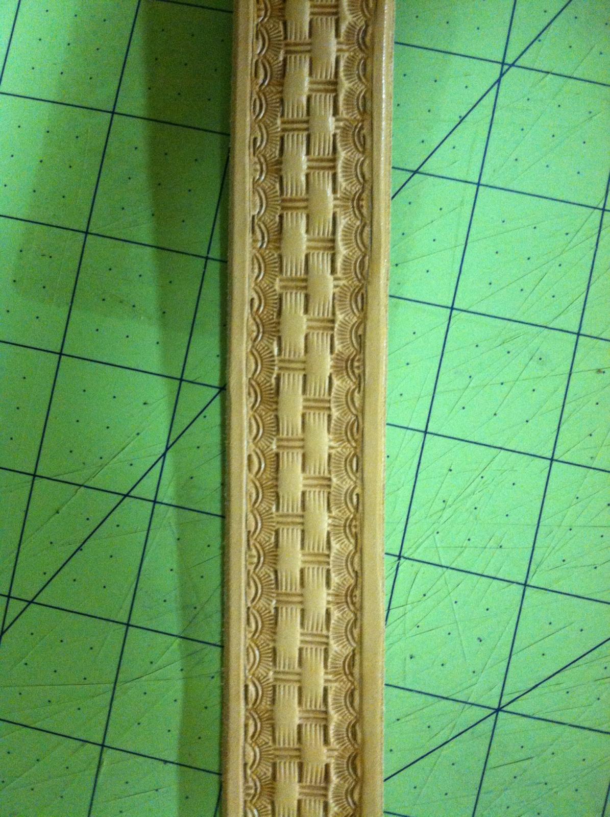

I'm making a belt for my dad....I'd like to pre-paint the border with Super Sheen as a resist, then use either an antique or a hi-lite stain on the tooling....leaving the border natural leather, the "innards" brown-ish. I did a test swatch just to see what happened, and when I slicked the edges (I used gum trag and a wood slicker), the burnish on the edges didn't look very good with the rest of the natural leather. Is there any way to get a nice edge without overly burnishing or changing the color so it doesn't contrast with the rest of the natural leather? Thanks for any thoughts you have, Widget
